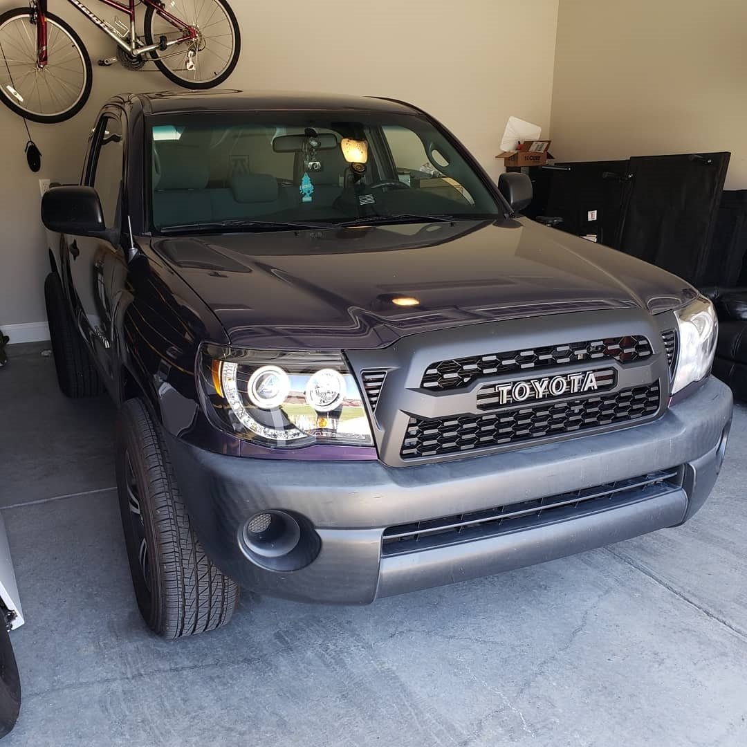

    I was wondering if anyone knows anything about a custom fitment intercooler, turbo, headers, camshafts, pistons, ect... for a 2.7 tacoma standard cab automatic transmission due to my leg cant do manual. Right now have a aftermarket cold air intake HPS Performance air intake, Magna flow exhaust nothing too major but trying.

    I'm not mechanic or tuner or anything really, but like how much HP? Is it stock internals for the engine? What kind of headers? Just the parts was being used though seen mentioned a used TRD turbo kit but modified. Cause manjority It seems like all are manual varients and this is my only vehicle dont want to make my transmission die
