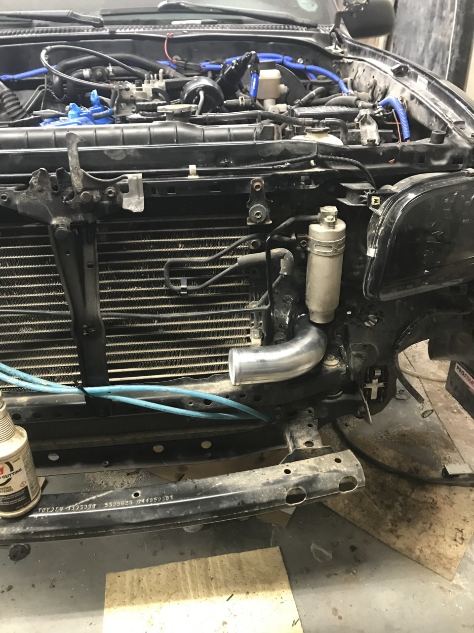

    I took next Monday and Tuesday off I’m determined to finish this 1F2ED7BD-E513-4EE7-B63C-D0D9AA6A051E.jpg

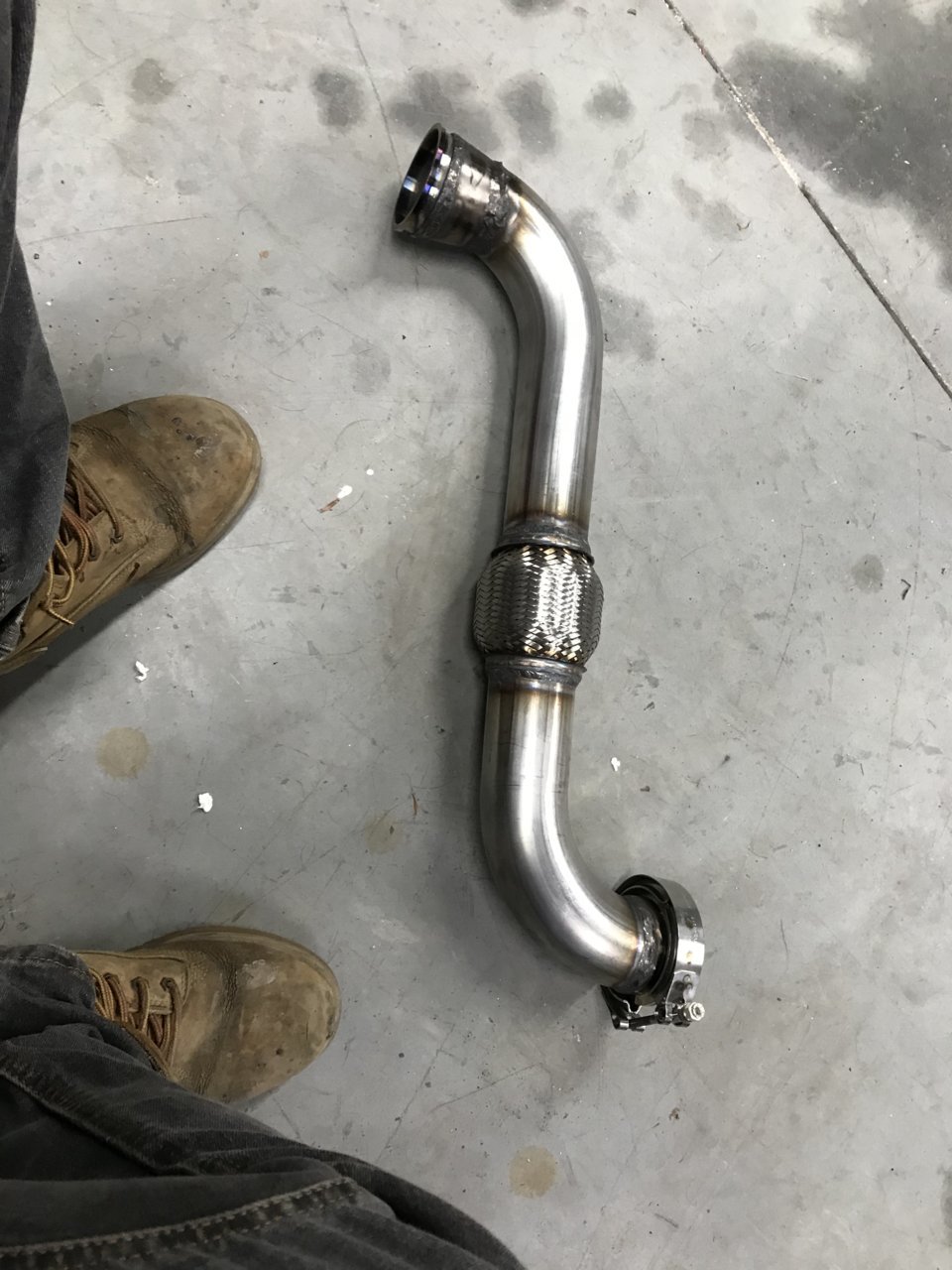

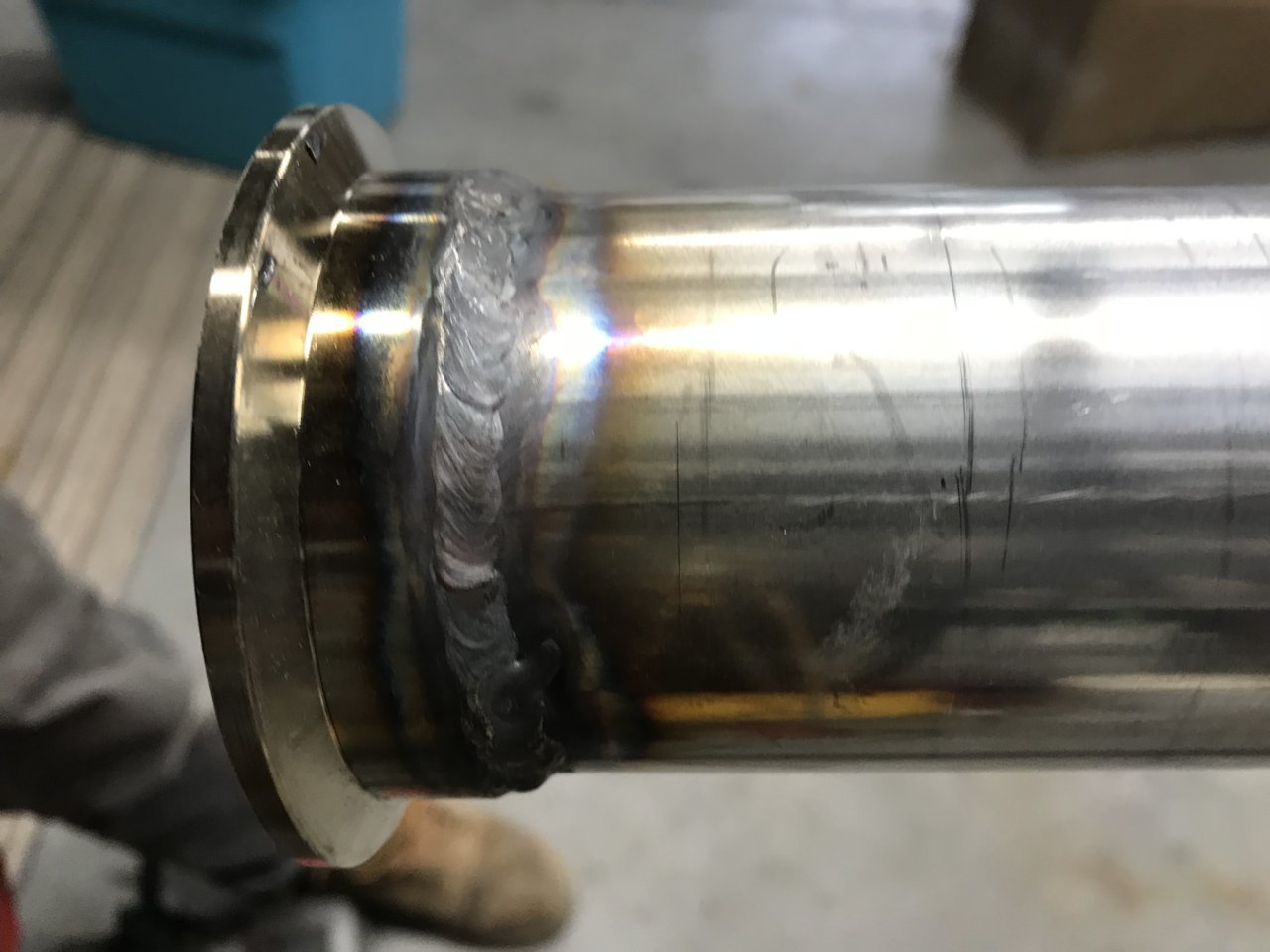

    Ic piping done!!!!
    Down pipe and pipe to black widow muffler finished!!22B7ACE2-C58F-423C-B7F3-8DCC238389E9.jpg

    Those welds on the DP look clean! Nick work, Jack
    Jcyr[OP] likes this.

    Thanks its no weld porn and i went over it a few times with the torch but I’m happy its all air tight!
    05Taco4x4 and boostedka[QUOTED] like this.
