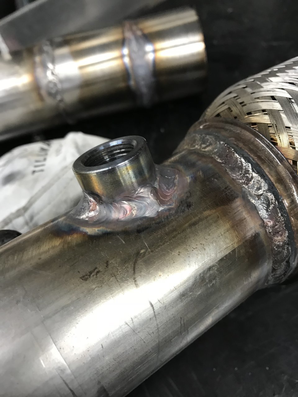

    @Torspd used a 12cup today think the color is much better

    Quite a bit. Notice the differences between the puddles around the bung and the flex coupling. Smooth versus rough. Good job mate. :thumbsup:
