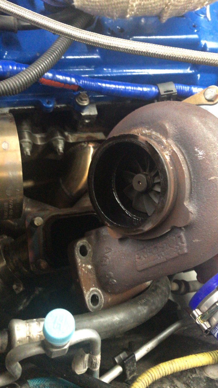

    Sooo some unfortunate updates.
    Not sure if it is due to some setup mistakes on my end so I’ll be adjusting then hopefully no more smoking exhaust

    We'll get you all sorted out.

    I don't think it was anything you did but always good to double check. Don't be discouraged. You've had some bad luck. Keep your head up soldier and be patient.

    Optimistically, this is the perfect time to troubleshoot your Idle Air Control valve, and wiring, if you had made any changes.
    I wish I would have known sooner that you had an IAC. That could very likely be the root source of your problems. Judging by what we all have discussed, it very likely is. As well as any changes that were made trying to tune around it.
