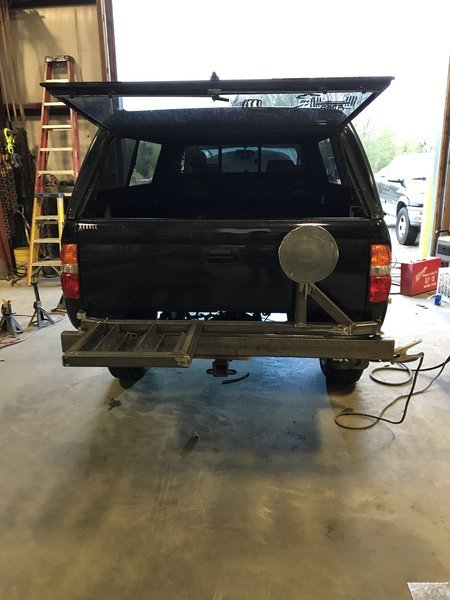

    Did some metal fab with a few friends. Couldn't be happier. Rear bumper+ tireswing out with dual jerry can and ammo case holder and square tubing sliders. IMG_0210.jpgIMG_0211.jpg

    Like the bumper, what did you use for the pivot spindle.

    I greased a solid 1" rod and welded it to a washer on the bottom. Then put inside of a steel pipe

    Because I'm road tripping it to Moab on may 11th (5 days from now) and am running around like mad...the bumper and sliders while they are what I want and envisioned there still needs some revisions down the road. But as of now it just has to be structurally sound.

    Did you have a recovery point added to the rear bumper so that someone can pull you out if needed?

    Reciever hitch can take a shackle for now might weld some permanent ones on eventually
