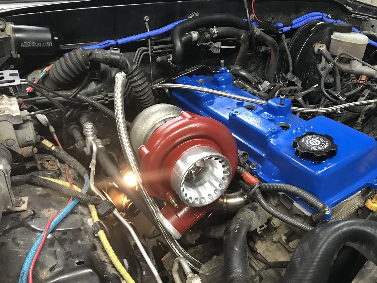

    Yeah I might get it powdercoated down the line but for now the hi temp ceramic enamel should be good it’ll also give ke good idea of how blue looks. All my intake couplers are blue and so is my bov and wastegate. With a red turbo for a bit of bling lol. Not sure what im going to do with my header being in new England i dont want to trap moisture in ther if i don’t have to but I think I’ll need some sort of heat shielding

    I’m really glad I decided to do this though I’ve learned alot already about my motor and am getting really comfortable working on it

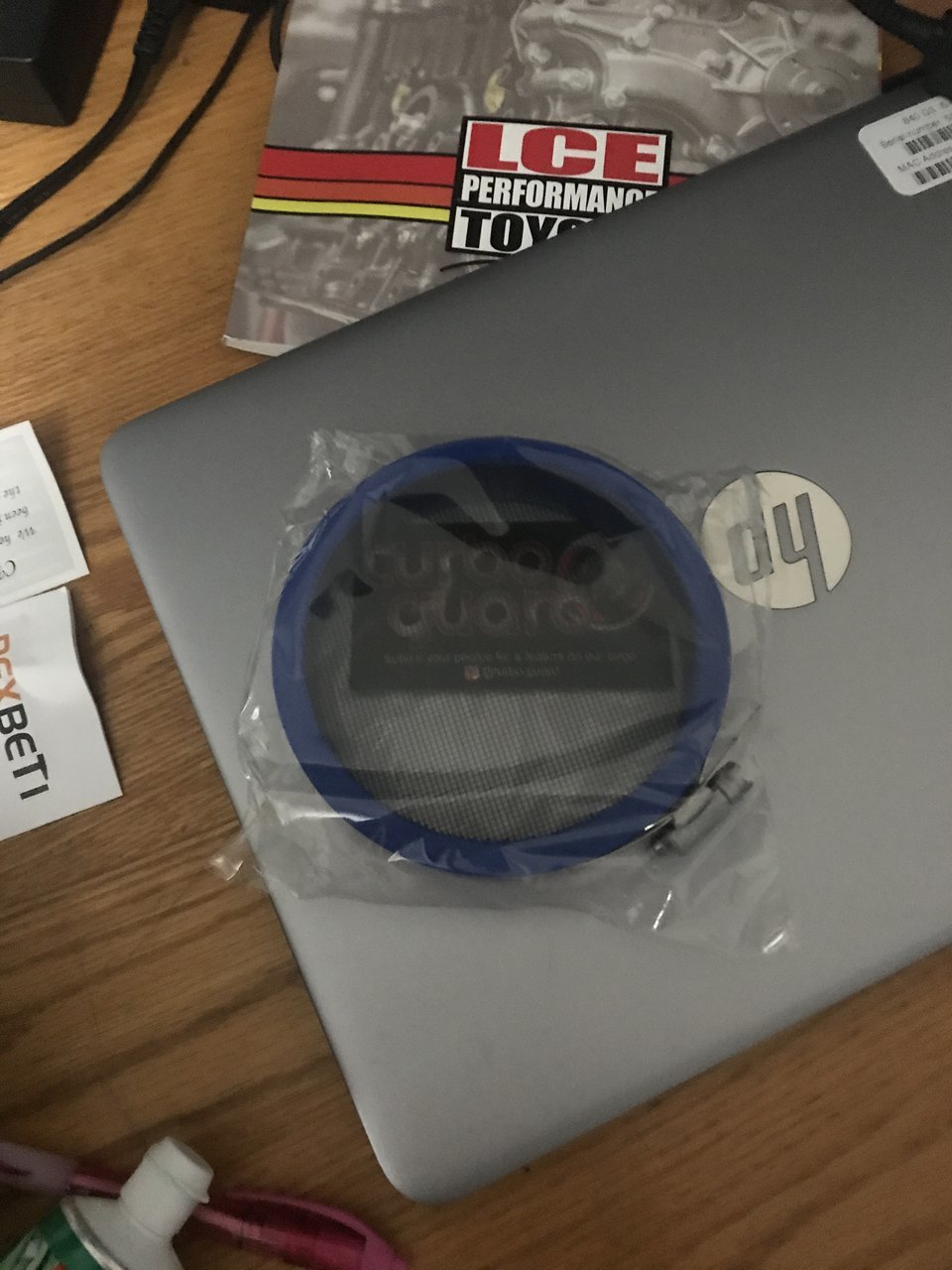

    Are you going to run the mesh exclusively or for tuning? I remember my buddy ran mesh on his 300zx for a long time and it ended up eating a compressor wheel over time and it shortens engine bore life too (oil changes all the time). Looks and sounds awesome though, so much spool sound haha :) Thinking I might buy the KO racing kit for shits and giggles soon...

    I plan on running the mesh all the tine besides time in the dirt... I’m okay with a shorter oil interval that is required when running just a screen. Also eventually plan on building a spare block with internals so if I only get a few yrs out of this one so be it
