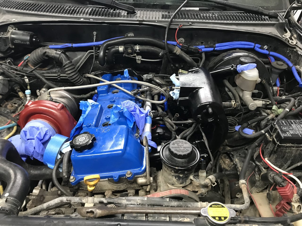

    Some major progress lately got the injectors and rail all set up and bolted the stock intake back together. Missing a few fittings to finish the fuel lines but they are on order!!! Then its plum the intake and weld the exhaust and wire the haltech then vrooommmmm8DBAB66F-B511-4A63-8894-456D6C1140F8.jpg
