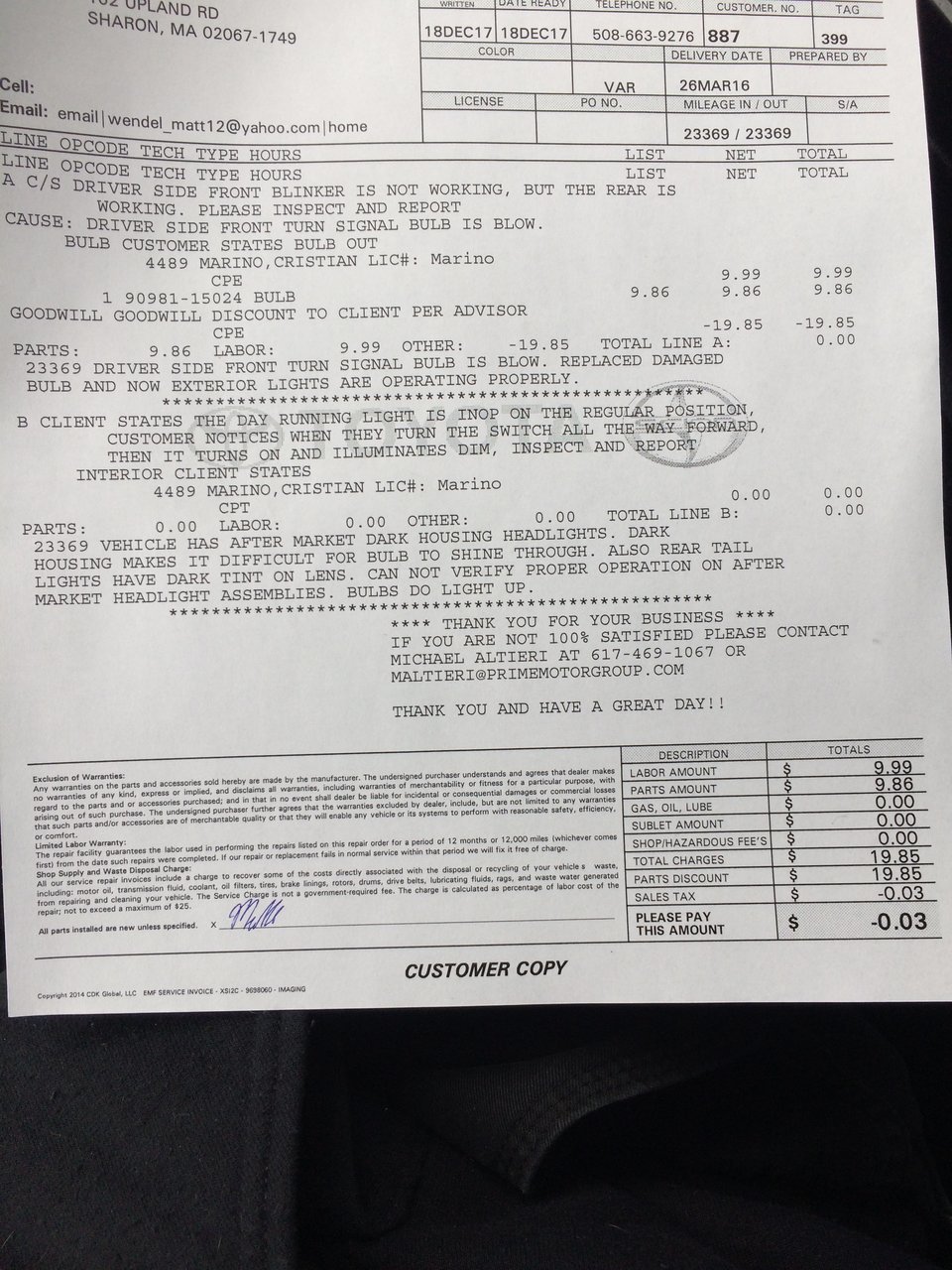

    At the dealership now. Took out my fuse block which was a bitch, also disconnected everything else from battery terminal, took off my roof light bar(they gave me trouble over it last time) and took out LED bulbs in headlight back to stock. Did what I can, hoping for the best. Been about three hours so far, it's a long one. Glad I brought homework.
    geekspeed and shakerhood[QUOTED] like this.
  17. Dec 18, 2017 at 11:39 AM

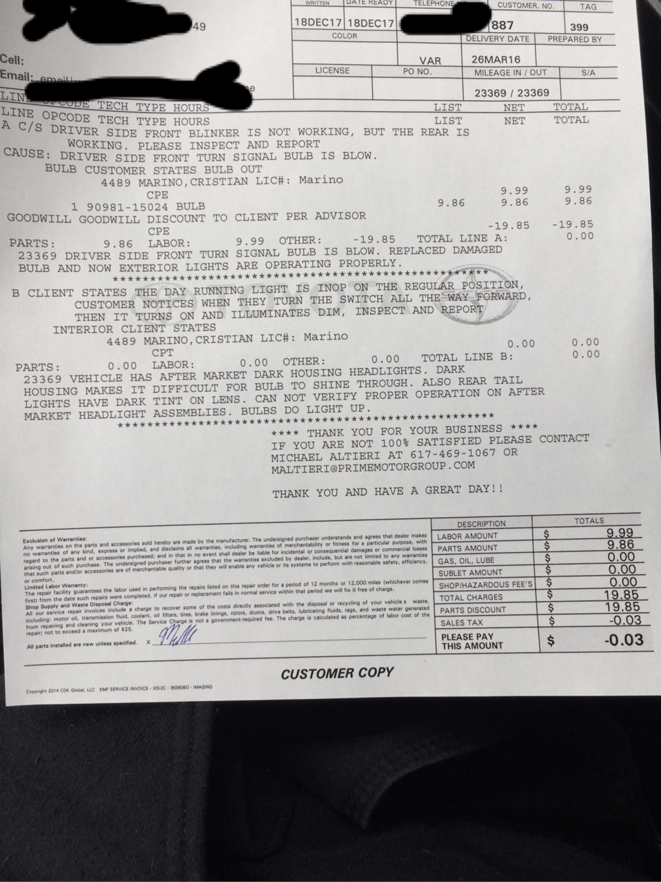

    I was there for about 4 hours, and appearently all they did was change the bulb on the driver side, and both DRL and turn signals now work. Not sure why it took four hours, maybe they were checking for other electrical problems. Either way, they covered the cost under wareenty and even the bulbs (which I don't think are warrantied). Overall great experience with Toyota again.

    Did they pay you the .03 cents?

    Not too sure how that worked out, but I think I drank more than .03 cents in coffee while I was there so I'll take the loss
