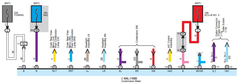

    I've been scouring high and low for a wiring diagram. There are plenty detailing the wires at the sockets, but so far they're really lacking in availability for the cab's circuit. Thanks for the help man, I'll pm you if I'm able to find any schematics.

    Flasher relay is built into the gauge cluster. Cannot he changed, or altered.

    This is insane. The Hazard switch is integrated into the air conditioning unit... ~$1,000 for a new one. And the flasher relay is integrated into the gauge cluster.... bloody hell.

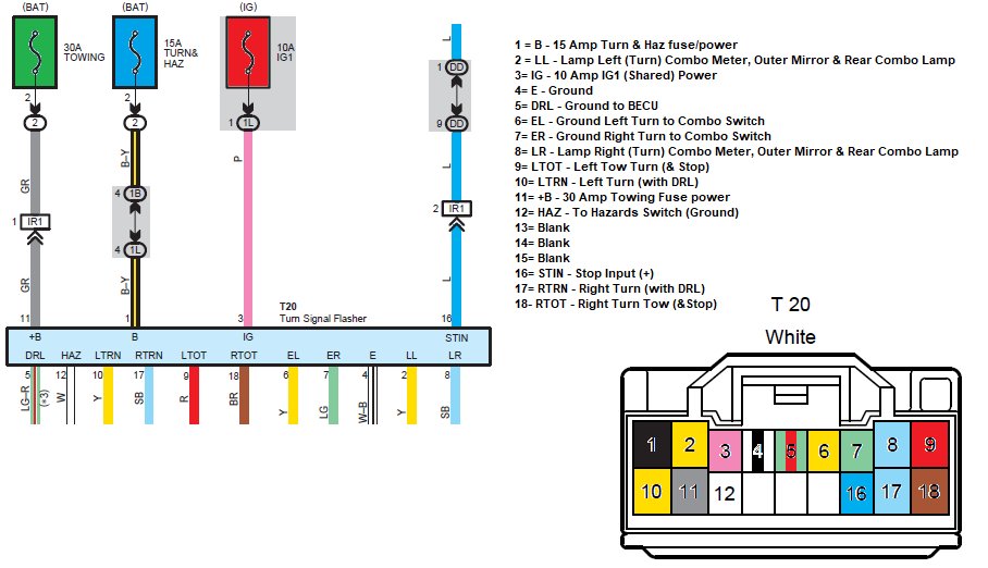

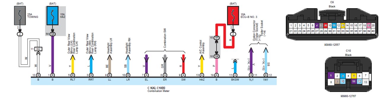

    You could remove the wires to the cluster and add a 2015 flasher...

    The "L" are to be T-tapped. The other removed (or cut n insulated) and connected to the 2nd Gen Flash Relay.
