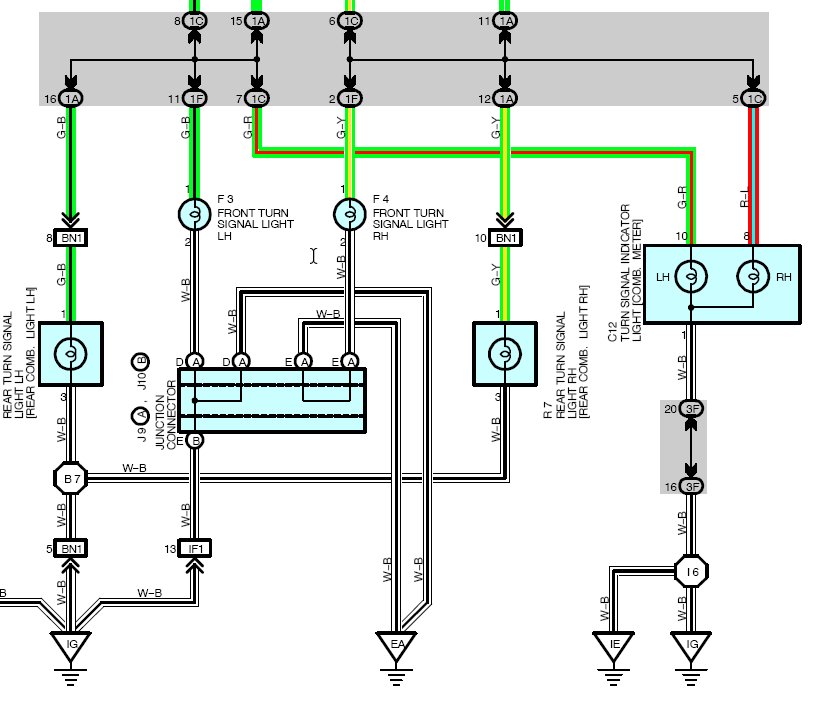

    Did not occur to me to ask about that :). These things change simple stock wiring into a nightmare.
    This is 99, but the same is in previous years:
    You see that front and rear are powered from the same junction connector, so if there is any magic, then obviously it is not your circuit diagram - trailer adapters can make funny things.
