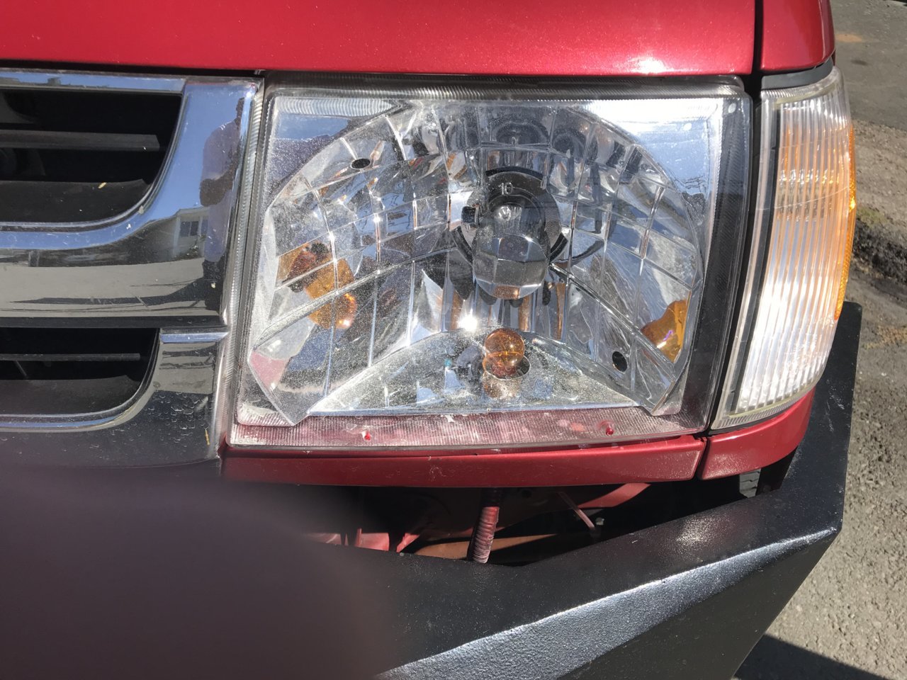

    I put a bumper on my 1st gen taco, it does have after market blinkers. When the blinkers are on, they flash rapidly, before they didn't. Has anyone had this problem, and what was done to correct the problem. It is annoying, thanks for the help.

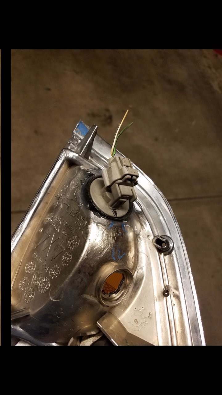

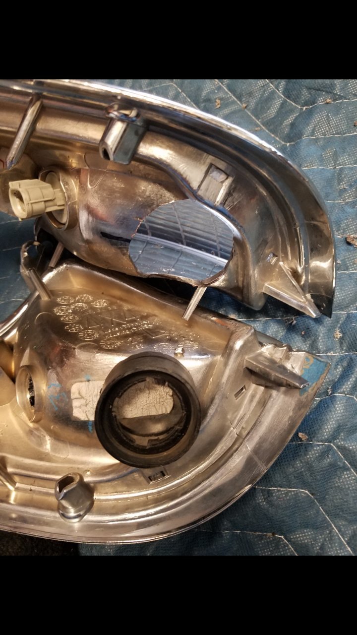

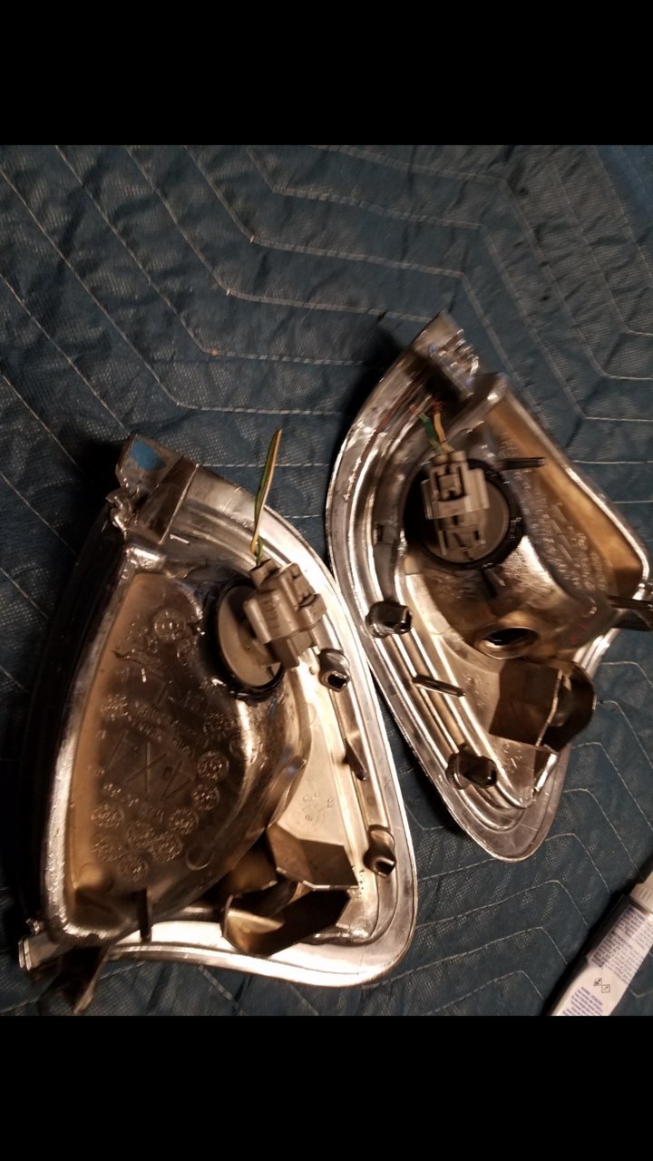

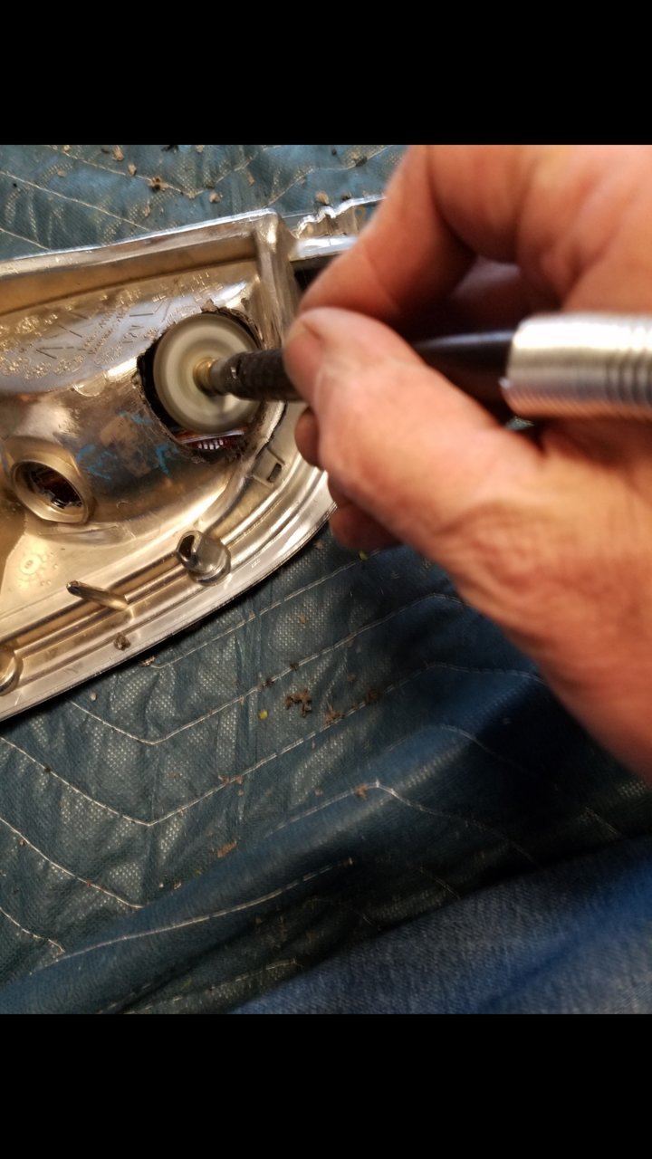

    I just did the the turn signal relocation mod, then used a quick splice so I have both the stock turn signal and the LED in the bumper:

    this is where I put my turn indicators.

    Can you wire them both with the stock bulbs instead of LEDS without issues on current or flashing?
    Or do they make a replacement LED that’s the same socket size.
    I was thinking of doing the same thing you did but keeping the sock bulbs and wired to the stock location and the side marker location

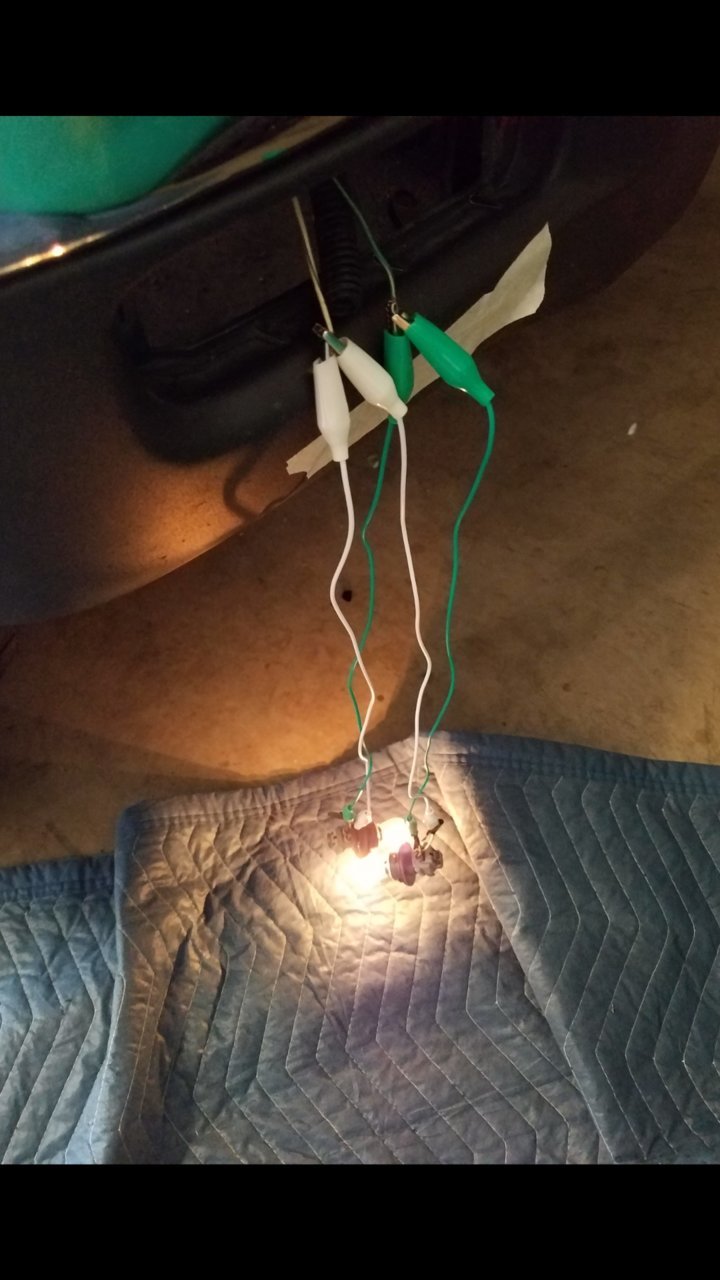

    So I did the blinker mods and kept the original blinker location infront.
    I tried using LEDS for all the 6 bulbs and LED EP35 flasher,
    BUT the front LEDs would not come on, just the rear LEDS.
    I put the stock flasher back in and it works fine with the LEDS in the back
    and the stock bulbs in the front with a normal flash.
    So going to just run it this way,
    4 Incandescent bulbs in the front for turn signals,
    LEDS in the back
    With the stock flasher,
    I did notice that if one of the 4 front blinker lights up front was disconnected it did hyper flash to
    let you know a bulb was out.
    https://youtu.be/7RlipH0TXaM
