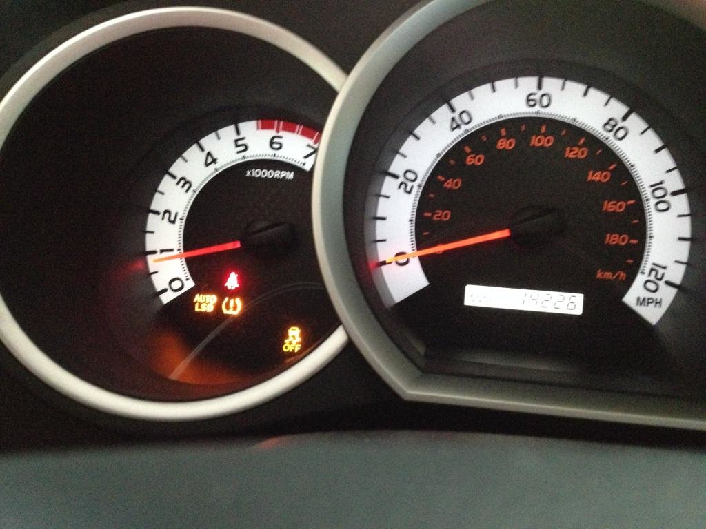

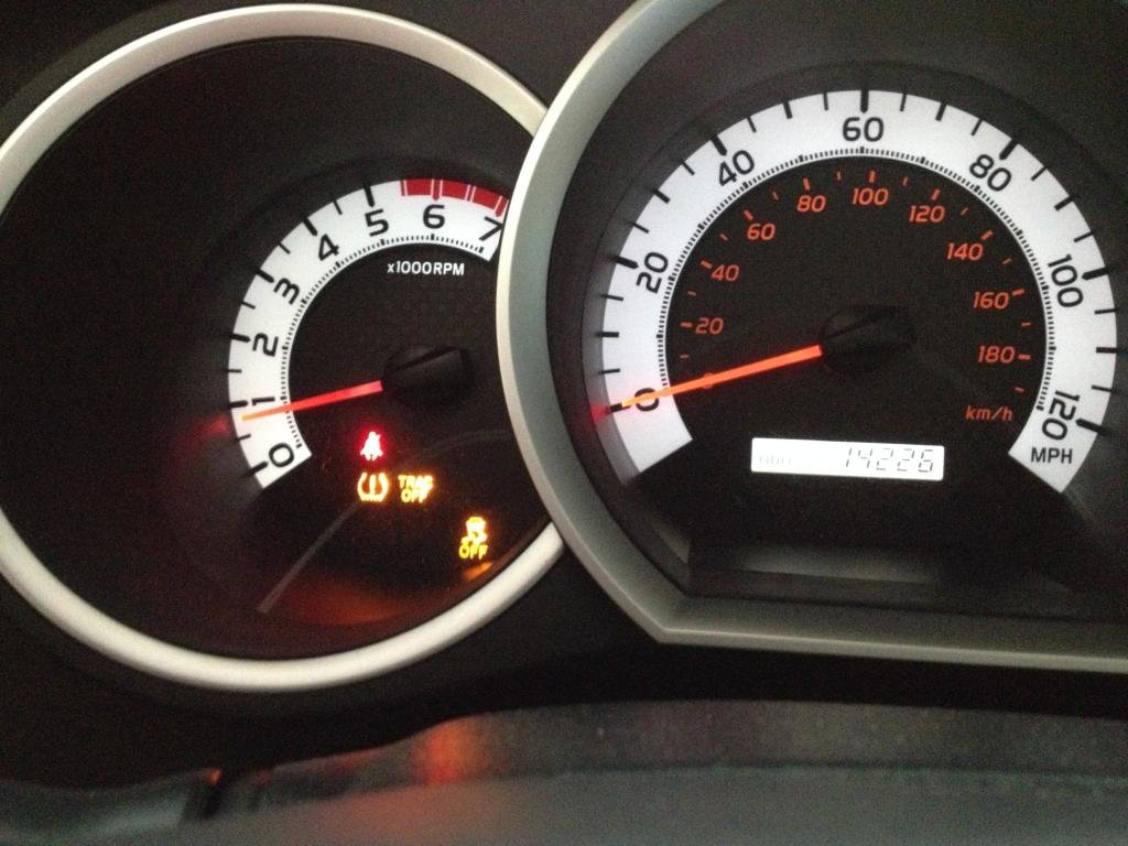

    Yeah. The LSD goes out. Id have to look at it again to see which other lights go out or come on. I can't remember at the moment.
    It's different lights than the 2011 that I had. Plus it doesn't make the beeping noise when it gets squirrelly like the 2011 did.

    One quick push.

    Long push.
