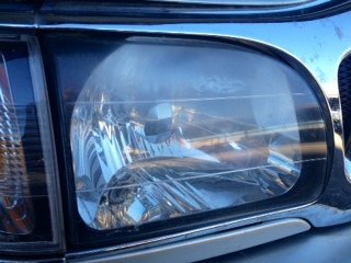

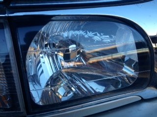

    Turtle Wax Headlight Lens Restorer did an amazing job!
    Only 9.99 at Advance Auto Parts.. Worth it if you need it.
    PRODUCT:
    BEFORE:
    AFTER:

    I used this same thing on both of my cars and it worked great but the yellowing came back on both cars in like 2 months. I don't know if that's because of Turtle Wax or Toyota

    Next time you restore your headlights, spray on a couple coats of clear and it will lost a lot longer!
