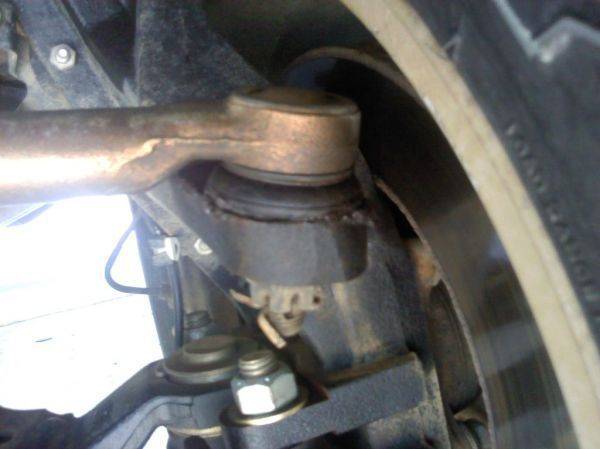

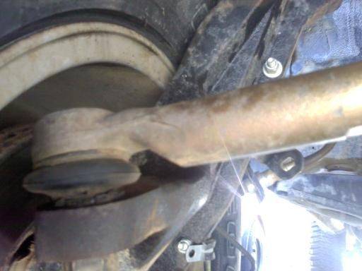

    bad tie rod end?

    can't tell by looking unless it's cracked and spewing
    unbolt it and check it for to much play. pretty simple to check and just as easy to swap out if it is bad.
    http://www.youtube.com/watch?v=hnNb3ZIJdKc
    Choose a greasable one if you replace it.

    im going to replace them with moog ones, its hard to tell what ones are greadable on the oriellys site. both my ends look different, they are both spewing grease ( almost none in them) and one sits higher

    Do yourself a favor and use a good supplier like Rock Auto... much better then the chain stores.
    If your not able to swap them right now throw a needle fitting on your grease gun and fill the boots up... it will ooze everywhere, but get you by if they aren't that bad.
    Oh and here is the correct part numbers http://www.tacomaworld.com/forum/2n...eplacement-part-s-general-bs.html#post3278586

    thanks for the help man, im going to get them soon
