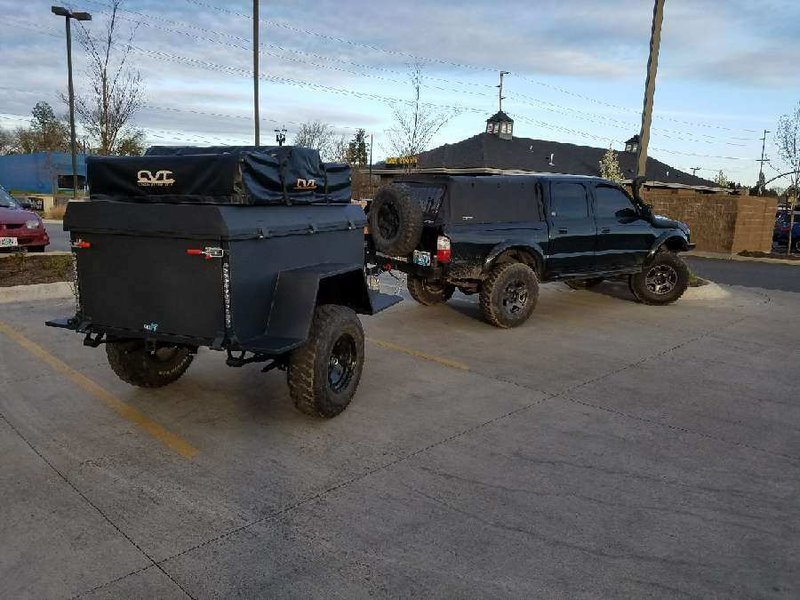

    IMG_6732.jpg I'm throwing up the "HELP" flag here folks! A good buddy of mine @DarkShark just called me from a hotel in Bishop, CA. He and his girlfriend are on trip heading to DV in his '03 Tacoma and he thinks be blew his front diff. It's making horrible grinding sounds and all the shops he called in the area haven't been much of a help. He had a repair shop that hung up on him and Toyota hasn't called him back. He doesn't know of any junk yards in the area, but if someone can source a front diff he has the tools and ability to install it.
    I'm gonna cross post this in the BS thread and tag a couple people in it. If he can't find any help he's gonna disconnect his front driveshaft to preserve his T-case and try to limp it the 150 miles to @RelentlessFab shop in Sparks. @JLee do you know anyone who has an extra front diff for a 1st gen Tacoma?
    He's towing his Expo Trailer and is over 500 miles from home, so if you folks could help out in any way that would be awesome.
