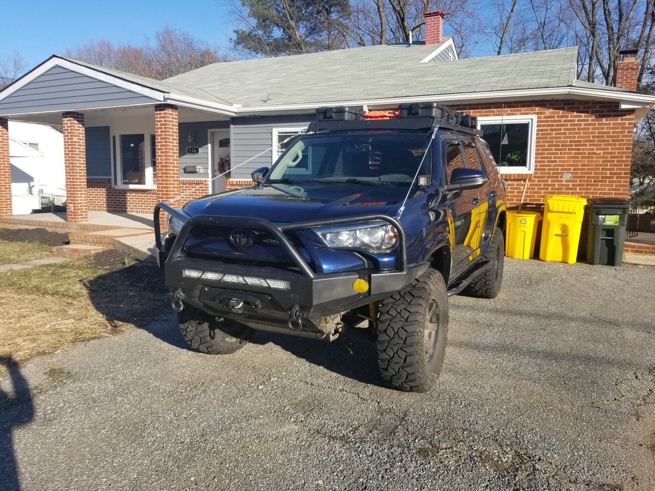

  9. Mar 11, 2019 at 3:06 PM
    #509
    twheat40
    twheat40 [OP] POOP Custodian
    Sep 24, 2017
    #230984
    2,098
    Tyler
    2017 4Runner SR5 Premium

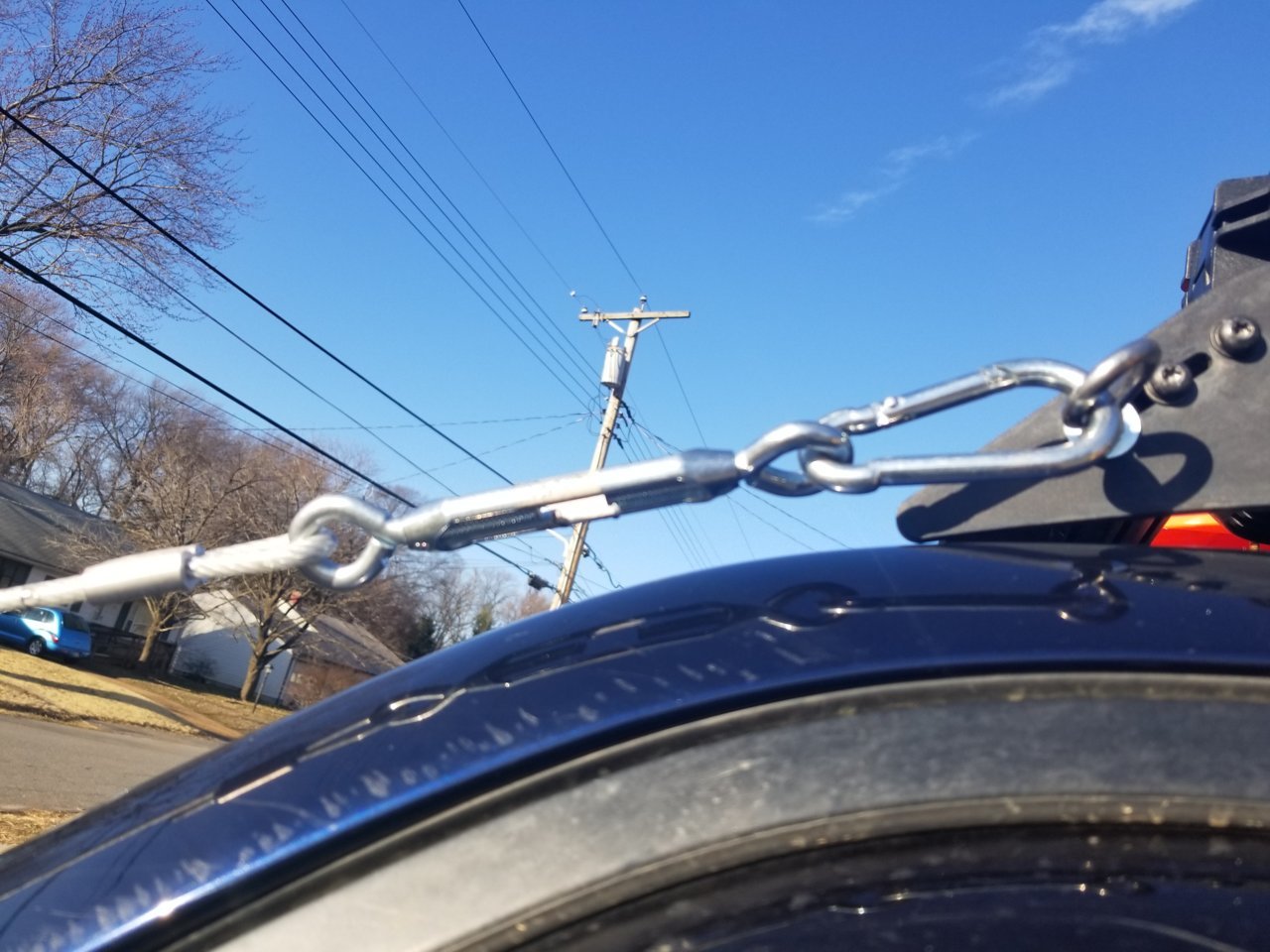

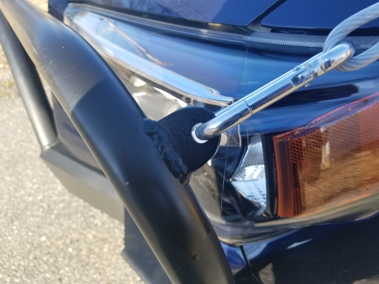

    Put removable limb risers on the 4Runner. I used 3/16" vinyl coated steel rope, 3/8" spring links, and 3/8" turnbuckle. Welded tabs onto the bumper and ran eye bolts through the prinsu.

    Damn, look at those welds.

    Did you touch that side up or is that mine?

    Nope, that was all you!

    God I need a better welder...

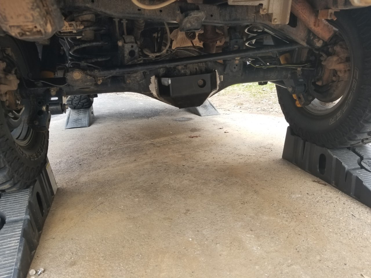

  19. Mar 15, 2019 at 6:32 PM
    #519
    twheat40
    Sep 24, 2017
    #230984
    2,098
    Tyler

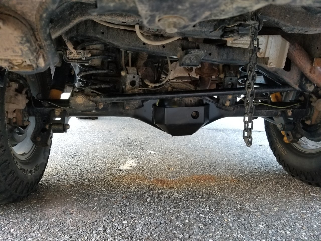

    @EatSleepTacos and I installed the trail gear diff armor today. They sent him the fj version and let him keep it after they sent him the right one. Well since the 4runner has the same diff, we tested it to see if it would fit and it did. So he passed it off to me like a bro.

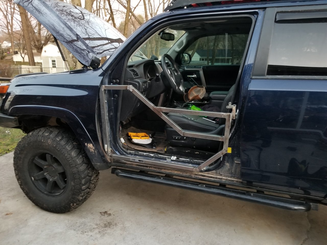

  20. Mar 23, 2019 at 5:51 PM
    #520
    twheat40
    Sep 24, 2017
    #230984
    2,098
    Tyler
    Completed my driver side tube door today. It was a pain, but it turned out mostly straight and I'm very happy with it. Hopefully I can knock out the passenger side tomorrow.
