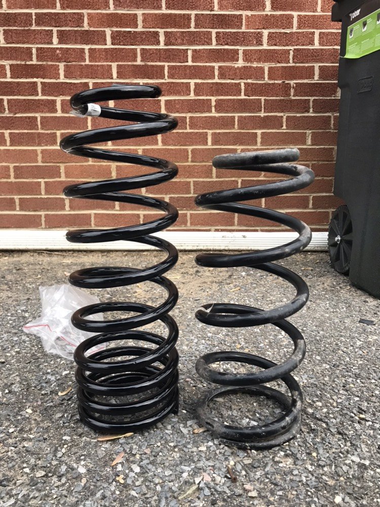

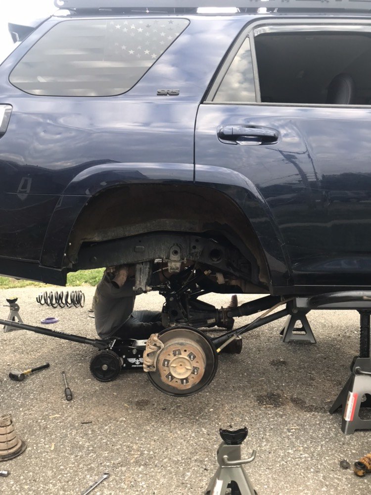

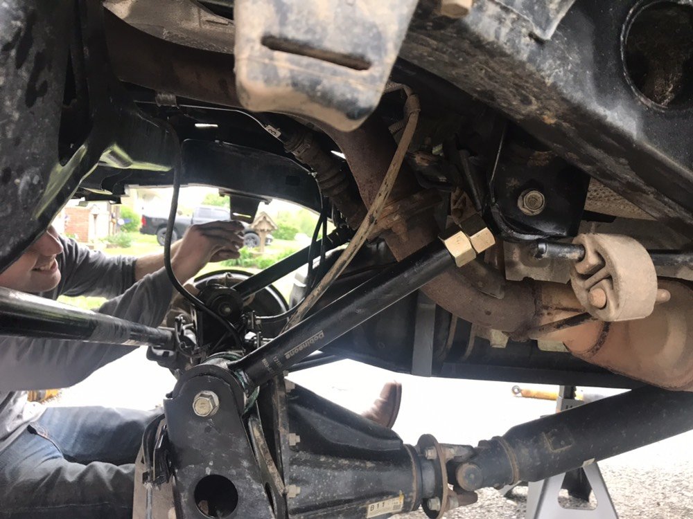

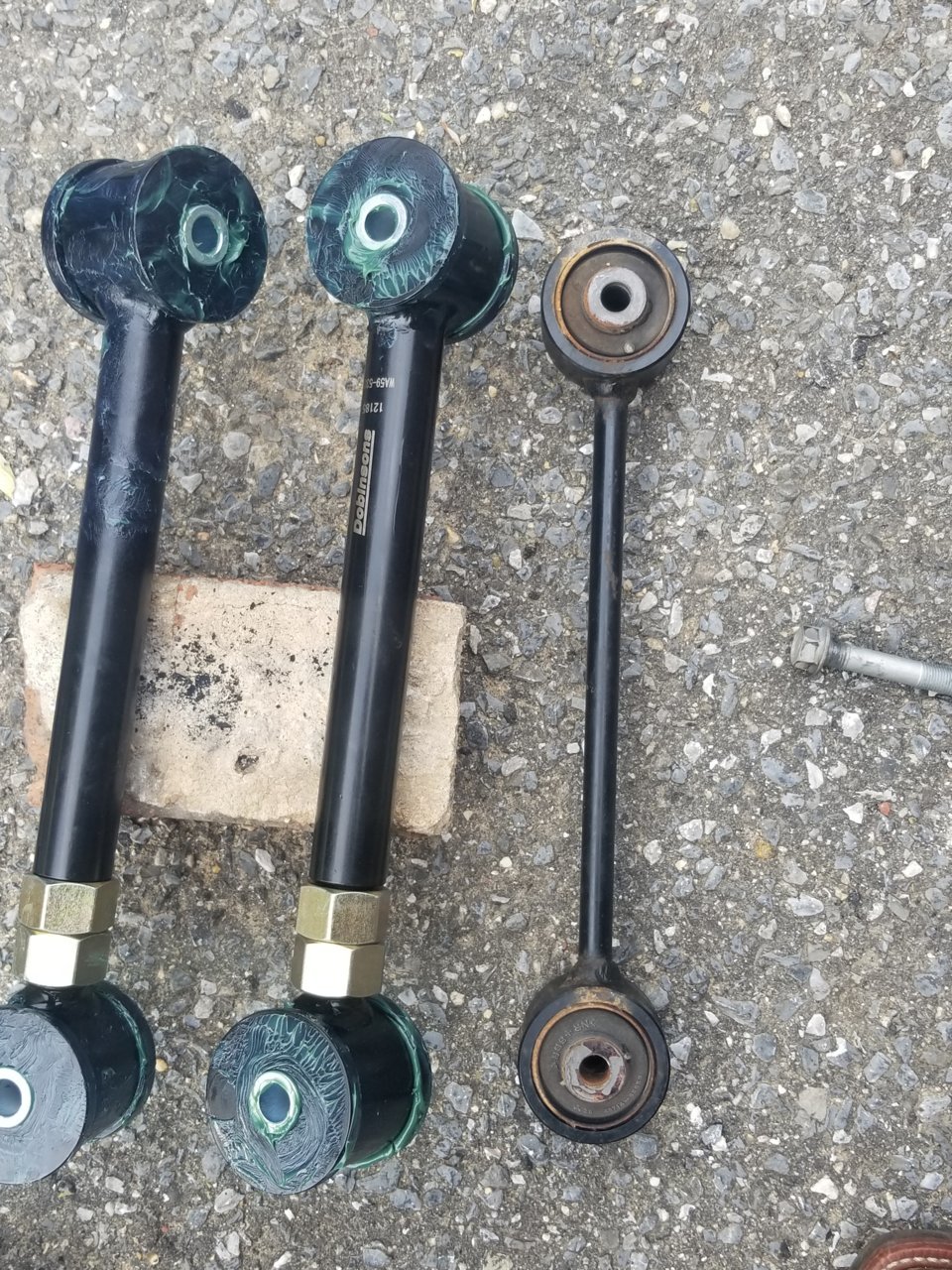

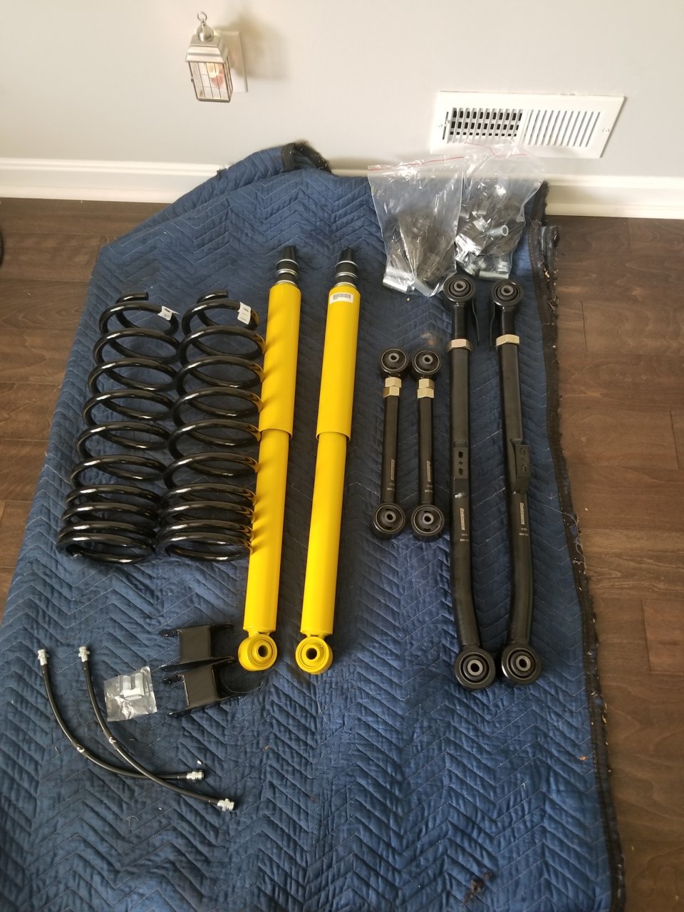

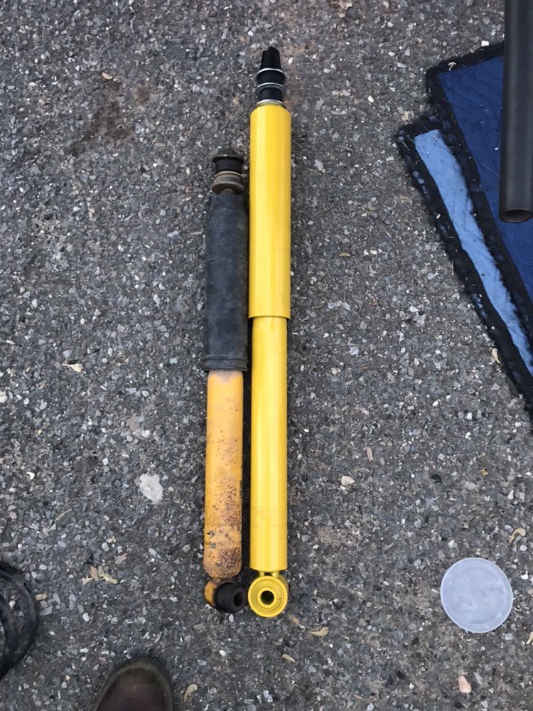

    Thanks to @EatSleepTacos once again. I got my new LT rear end from @Dobinsons Mike and the brake lines from Crown Performance.
    This is really well engineered and definitely gonna be fun to use on the trails.
    Full droop before was 27" from fender to center hub, after is ~32.5". Very happy with this product. The lower arms will be going on later in the week.

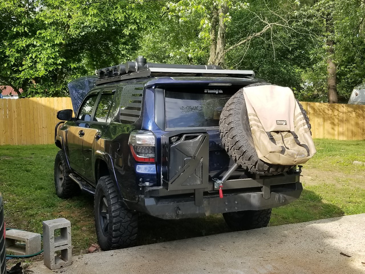

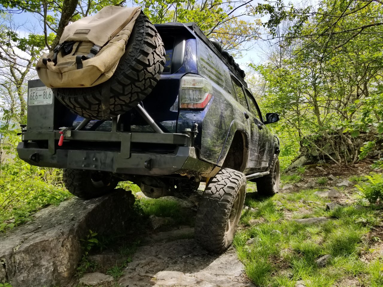

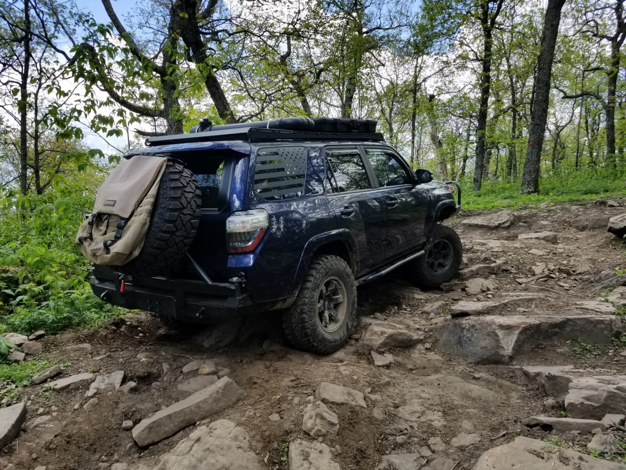

    Welded a fuel can holder (courtesy of @EatSleepTacos ) to my second swing arm. Also added a trasharoo to the spare tire.
    Got the chance to stretch out the new suspension at Potts Mt. It performed excellently. It stayed planted most of the day, and felt really solid in off camber situations.
    However I need to add spacers now because the tires rub the inner fender liner at extreme articulation.

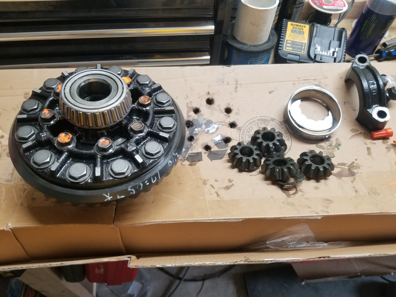

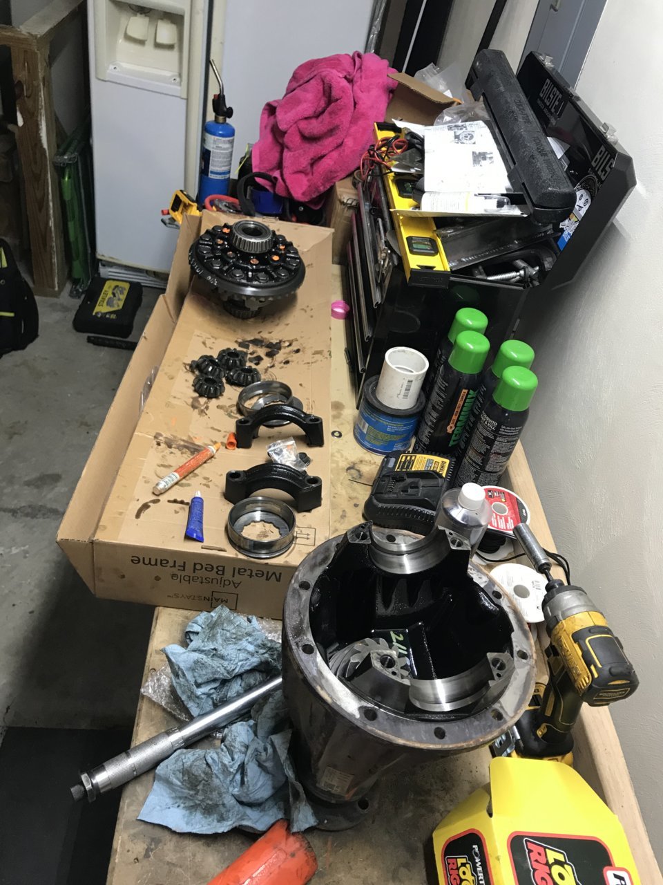

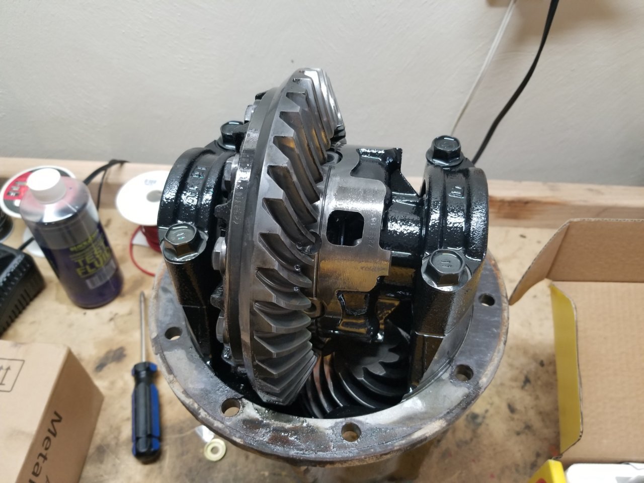

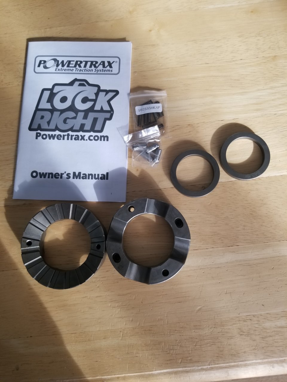

    Got this in the mail today. Powertrax Lockright Mechanical Locker. I've done a lot of research on whether or not this will work on the 4Runner, since I cannot find any examples of anyone installing one on a 5th gen. Everything pointed to yes, including the guys over at ECGS saying that they agree it should work just fine, so I decided to pull the trigger. I will be meeting with @EatSleepTacos to install it sometime soon, then I will be doing a write-up on it on here as well as t4r.org once we finish and confirm it works.
    Since I have recently done the daily driver mod, I do not drive the 4runner around town much and as such am not as worried about the road manners. I've also gotten to the point where ATRAC has started to let me down on some obstacles, so it's time for a locker.
  18. Jun 2, 2019 at 3:41 PM
    #558
    AR15xAR10
    Apr 13, 2013
    #102024
    56,759
    08 SR5 4x4 V6 IndigoInkPearl ACLBFTMFW
    :woot:
    twheat40[QUOTED][OP] likes this.
  19. Jun 9, 2019 at 10:25 AM
    #559
    twheat40
    twheat40 [OP] POOP Custodian
    Sep 24, 2017
    #230984
    2,095
    Tyler
    2017 4Runner SR5 Premium

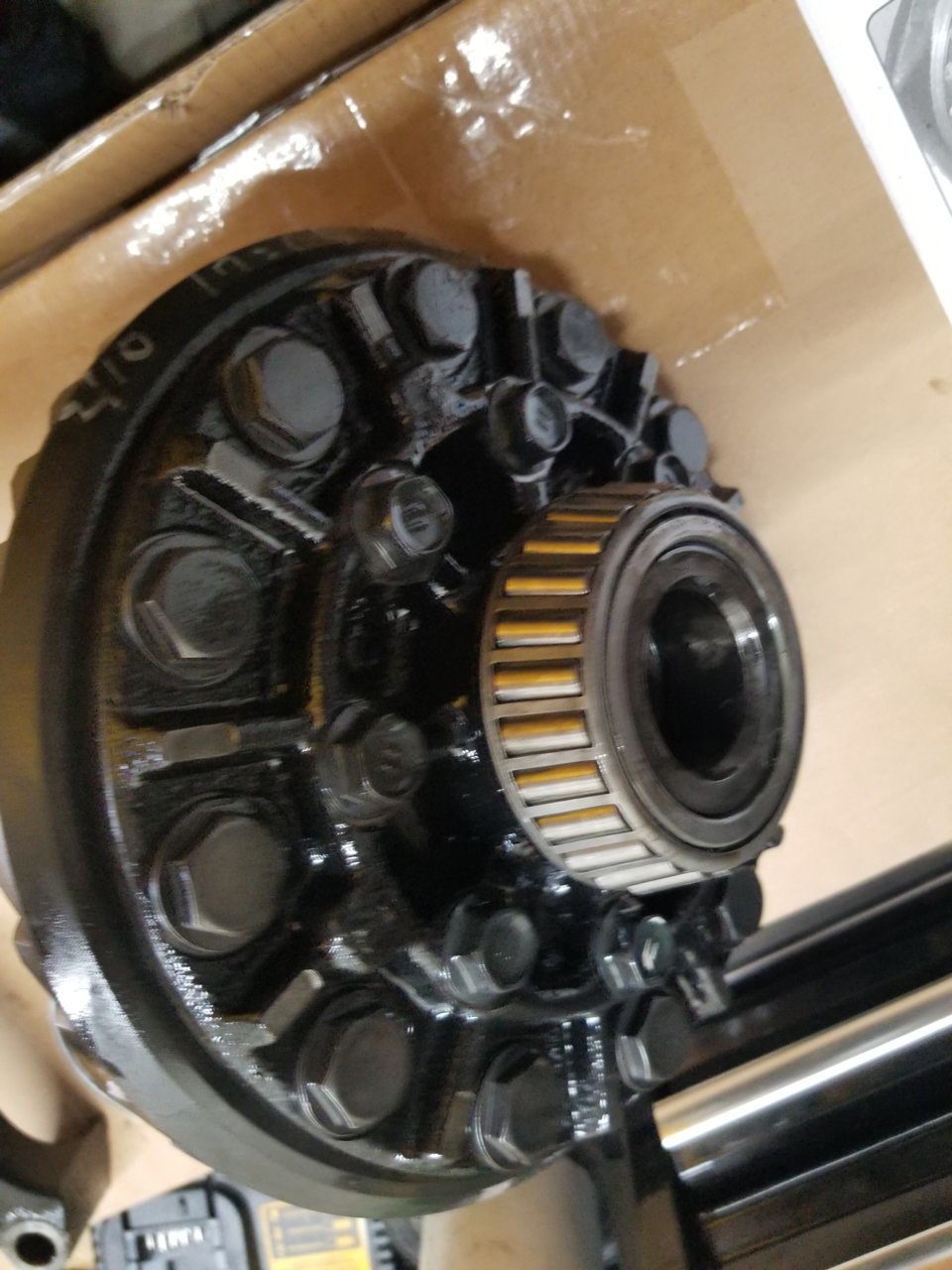

    Installed the Powertrax LockRight 1620-LR yesterday. Everything went surprisingly smooth. We ended up finding and following a write-up for a 3rd gen 4runner install, which is almost the exact same process. I might end up doing my own write-up on t4r.org explaining the differences.
    Overall install time was about 4 hours and then waiting on the gasket to dry overnight.
    The one thing I have noticed is that the Lockright does click a lot around turns, which doesnt bother me at all, but it might bother some. It's not a crazy loud clicking, and I can only hear it with my windows down, but it is still noticable.
