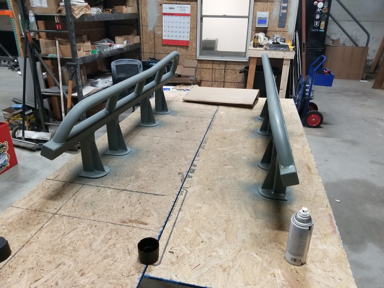

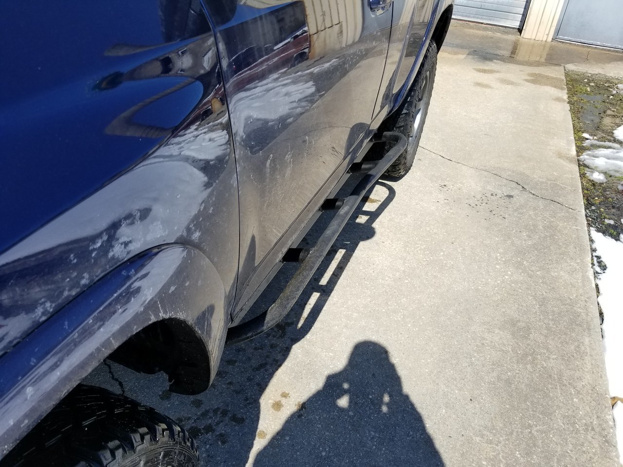

    Got my @Mobtown Offroad Weld-on Sliders installed today. @EatSleepTacos helped with painting them. We used self etching primer and satin black paint.

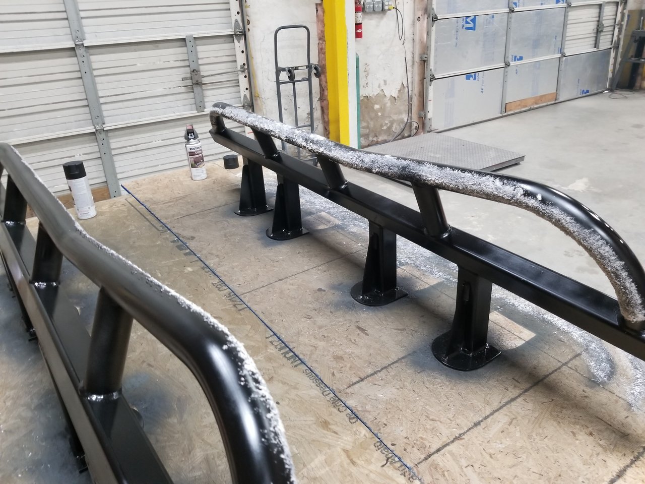

    After a couple of coats of black paint, we spread sand along the top side of the rail to give it some texture and make them less slippery when wet. Once that layer dried, we applied another thick layer of paint and then a touch up layer.
    They are really sturdy and I can't wait to put them to the test on some rocks.

    How is the sand holding up so far?
  8. Mar 22, 2018 at 7:05 PM
    #148
    twheat40
    twheat40 [OP] POOP Custodian
    Sep 24, 2017
    #230984
    2,095
    Tyler
    2017 4Runner SR5 Premium
    Surprisingly well. I had Elizabeth basically dance around and jump on them, and only a bit came off, which is probably where it was clumped up underneath the top coat. I think if we can refine the process a little, then it would work wonderfully.
  9. Mar 22, 2018 at 7:07 PM
    #149
    EatSleepTacos
    Mar 24, 2015
    #151688
    59,841
    Randy
    West Valley, AZ
    2017 4Runner
    That's good to hear! I wonder if once the paint is nice and dried if we laid down some sort of thicker protectant if it would help. I'm not sure what though. Maybe some sprayable glue or something
  10. Mar 22, 2018 at 7:08 PM
    #150
    twheat40
    Sep 24, 2017
    #230984
    2,095
    Tyler
    I was thinking sprayable glue. Then maybe using a paint brush to lightly brush the excess sand off.

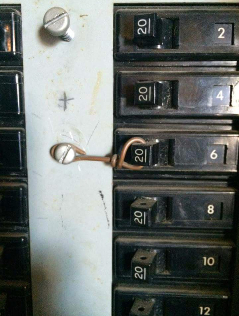

    Only took me 8 hours and tripped the breaker 53 times :D

    Dude! You should just wire the breaker to a nail on the opposite side so it wont trip. Old electrician trick :devil:

    @Redmann would approve this :laugh:

    Problem solved! Saves me from having to walk over and trip the breaker back each time.

    Thank you! Lol no. The guys in the shop did. Randy only welds inside his own house.
    This is such a bad idea, but it does in fact work. Still a horrible idea.

    Bro why else would the manufacturer of the breakers put little holes in the breaker handle? Think about this Randy
