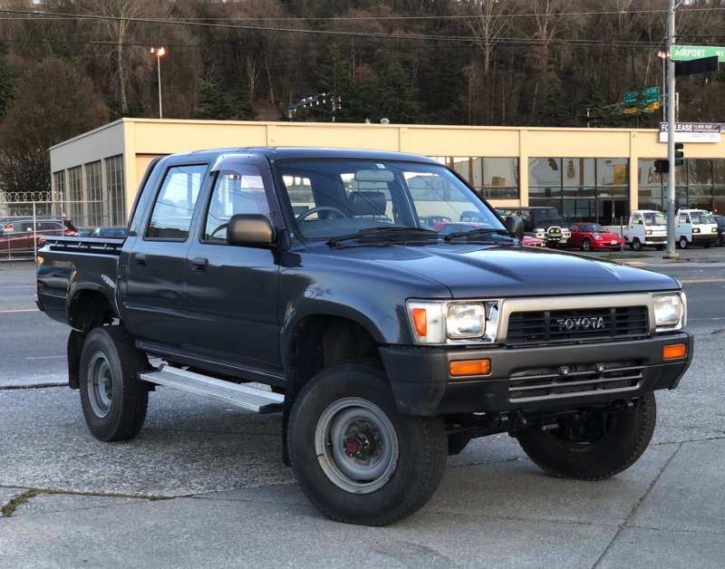

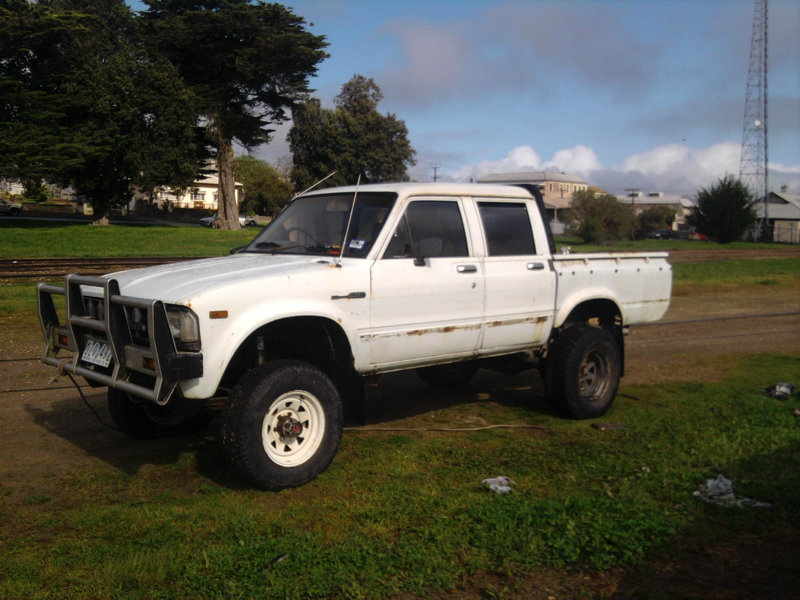

    The truck up to 1995 was very similar to the Hilux. Early on Toyota called the trucks here Hilux, up until 1975 I think. After that the vehicle we got here was just called the "Toyota Truck." Mine was a 1991 that came from Japan with a box made in Japan so AFAIK it was a left hand drive Hilux without being called a Hilux. In 1992 Toyota started building some trucks at NUMMI in Fremont, CA, and eventually all trucks sold here were made there.
    When people import them now it's for a few reasons. One is to get a solid axle version (Toyota didn't change the Hilux to IFS completely until 1997, they were sold globally in both IFS and solid axle from 1986 to 1997 but we only got IFS after 1986.
    Another reason is to get a diesel engine truck and a third reason is because the Hilux came in Double Cab way back to 1979 but we never got a 4 door pickup until 1995 (edit: actually 2001) with the Tacoma. Also overseas the Hilux has the option for an external hook box and two latches instead of a center handle.

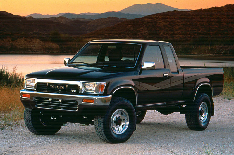

    For example, a 1989-1991 U.S. XtraCab Truck:
    A 1989-1991 right hand drive Double Cab Hilux:

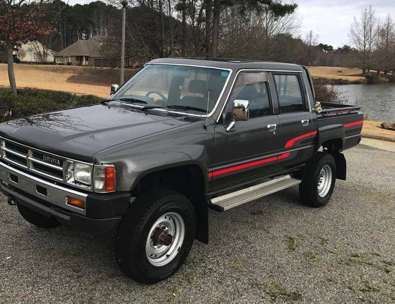

    And just a FWIW.
    79-83 Double Cab
    84-88 Double Cab

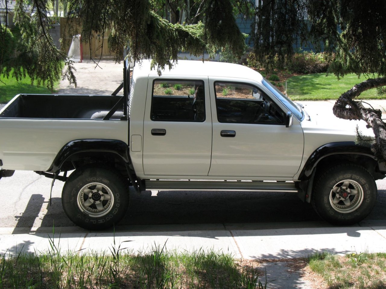

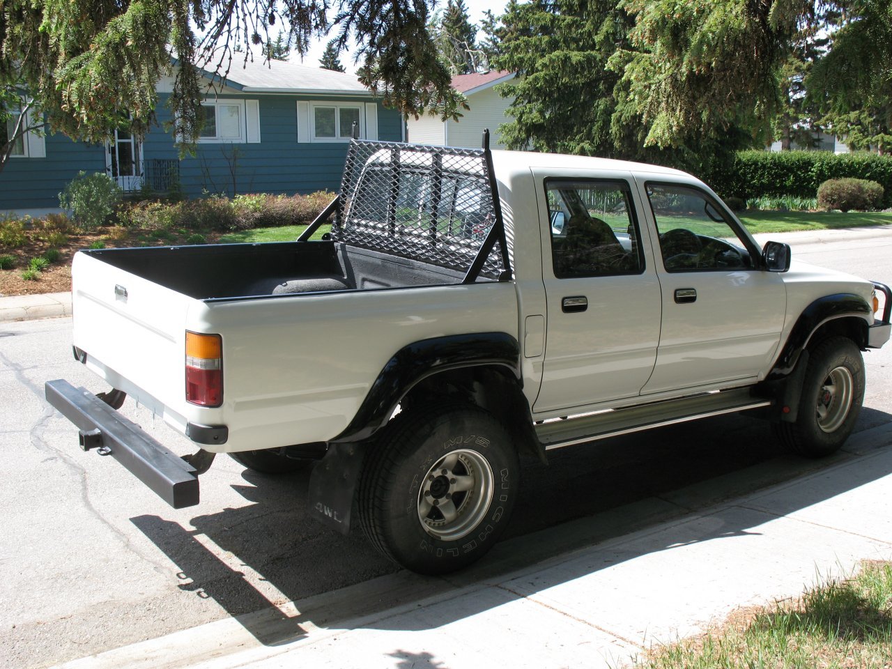

    1992 Toyota LN107 JDM Double Cab 4x4 5 Speed Diesel
    2" Lift running on 31.5 x 10.5 Michelins x 15" JDM 2-piece aluminum bead locks Monroe Gas Shocks ARB Front Bumper & Winch
    1992 Double Cab - JDM LN107 - 5th Gen Hilux with IFS..... :cool:.... 3L Diesel
