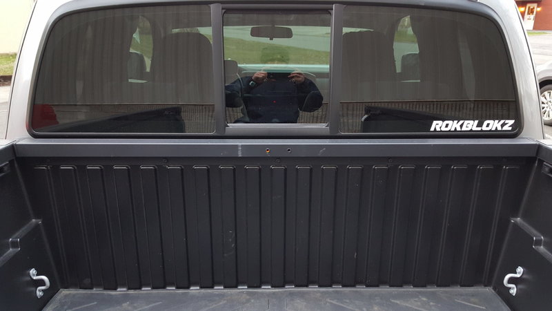

    you are speaking of these?

    Mine came with the factory tonneau. It has a block mounted there to locate the front of the cover.

    It's where the factory tonneau cover connects to the bed

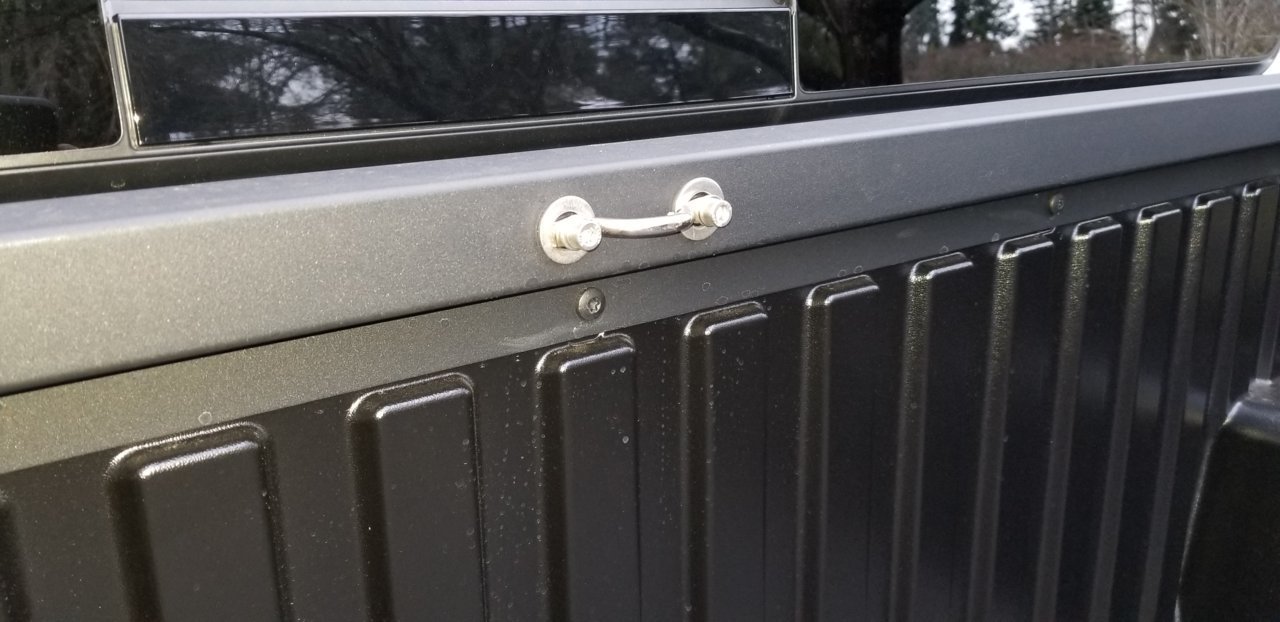

    I did this, added a SS hook and SS hardware, locktited the socket head cap screws in place, used some washers to space the hook from the rail. Super light duty, maybe bed net, tieing up the mtn bike, etc...[​IMG]

    What size screws did you put in there. I have a whole workshop and can’t find any.

    Gonna guess at M6 x 1.0.
