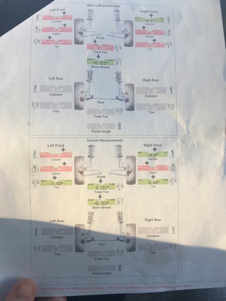

    Just got an alignment done. Should I be seeing better numbers with Uniball UCAs?

    They didn't adjust the caster at all. Which is interesting. But as long as you don't have any rubbing, you're fine.
    edit- Technically speaking you should be able to get more castor than stock. Say 3 degrees rather than your 1.8 or 1.2. This just pushes the tires slightly farther away from the firewall. Not a big deal. I personally care about handling characteristics more than pushing the tire away from the firewall.

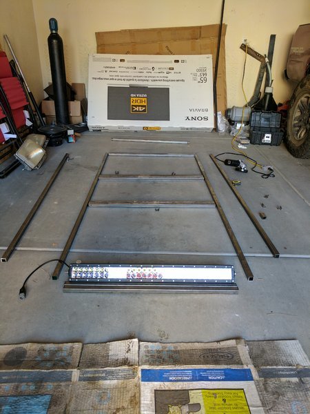

    It's coming along. Slowly but it's better than nothing haha

    Drives straight and no shakes at speed so I'll consider it okay

    That looks like bullshit to me, all they did was adjust toe. They could at least even out the camber, I would take it back.
