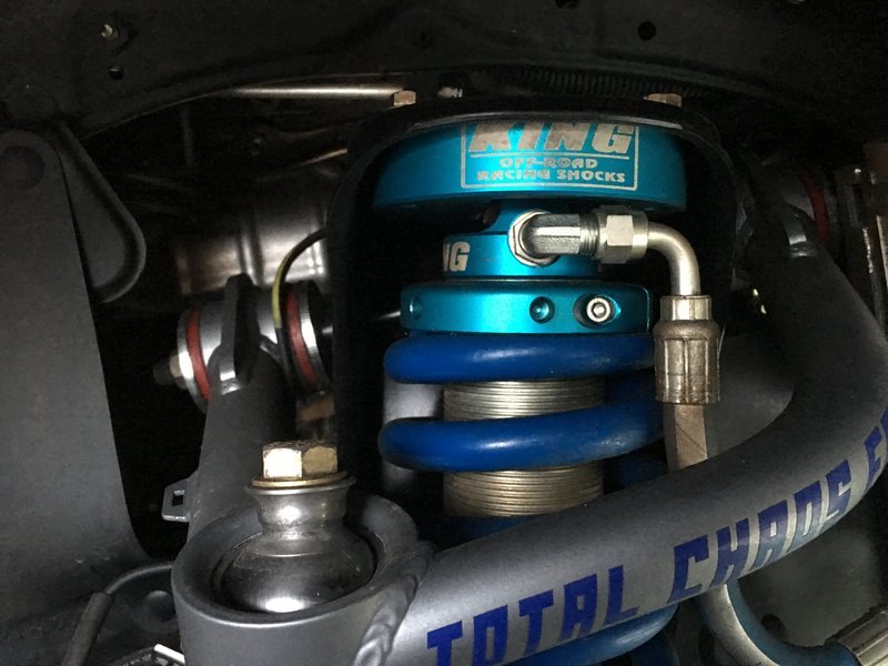

    @LTDSC @dtaco06 this is why I recommended 650#.
    This is my truck, currently at just a hair under 3" lift, CV fins barely touching. RTT, Shrockworks full plate bumper (probably the heaviest 5th gen bumper), winch, battery, full steel skids.
    Maxxed out on adjustment threads, cannot go any lower unless I maybe add another battery on that side. But I already have an ARB twin + air tank, so might be a moot point in terms of weight over that axle.
    On the driver's side I have a 31M and the gas tank, so I was able to have some room for adjustment.

    jealous of the lack of threads. What length springs?

    I will have my 75 lbs bumper insert, 75 lbs winch, a single optima red top battery, aluminum skids. I'm very preloaded on my 650s though.
  12. May 17, 2017 at 11:42 AM
    SixthSnail
    SixthSnail I have no idea what I'm doing
    Oct 3, 2014
    #139599
    13,289
    Los Angeles
    '14 Tacoma Sport
    See Build in Sig
    That is passenger. Driver is worse.
  13. May 17, 2017 at 11:44 AM
    4Running Daily
    4Running Daily Long Live ZS
    Mar 25, 2012
    #75625
    8,702
    Connor
    Tempe/San Diego
    1996 Toyota 4Runner
    Those are only 13" coils though. King coils are 14". It's less preload than you think

    @4Running Daily said what I was just about to say. Icons come with 13" 650# coils, Kings are 14". So already you have to preload the Icons a bit more to compensate for that 1" loss at the spring.
