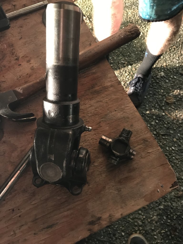

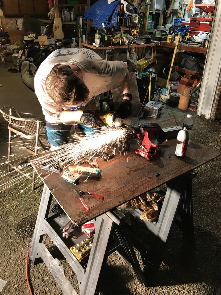

    Oh don't worry @MattJakobs uses an angle grinder to do u joints

    But did it work?

    Oh deff yes and saves time too.
    Dang bro we were productive new upper and lower rad hoses for me and an alternator swap back to my 200 amper and she's kickin solid now.
    You got your whole engine bay rewired and a new rear u joint.

    Sorry, I'm not getting it. Why would you hack off two sides? Are you using oversized U-joints? That still seems like it would F up the needle bearings and lead to an imbalanced drive shaft.

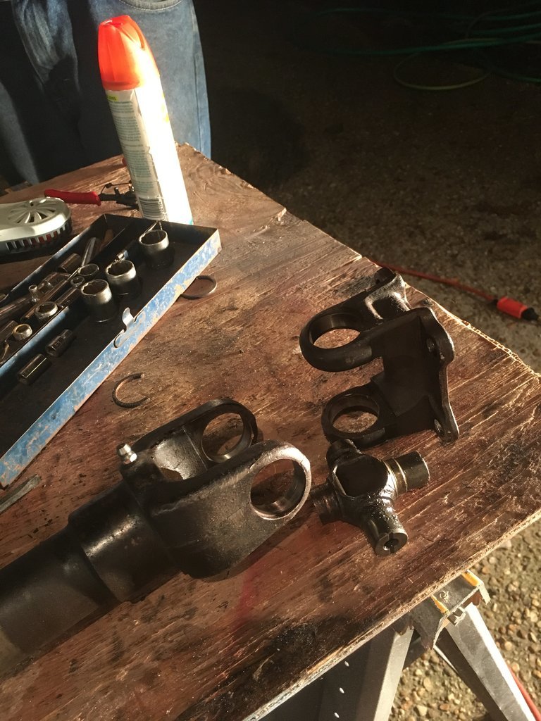

    yes it destroyed the needle bearings, but those were worn out and we put all new caps, needle bearings and u joint. instead of pressing it back through to get the second cap off we cut it out. we didn't have a press so we were using a vice and a hammer...made it a bit quicker and who doesn't like using a grinder.
    @MattJakobs had vibes under acceleration and coasting, after we finished they were magically gone.

    Using an OEM U Joint but that sucker is pushed in there tightly. With the amount of time it took to get two sides and caps off, it was just easier and faster to cut it out. The U Joint kit came with new caps with needle bearings so I wasn't worried about destroying the old ones, especially after looking at the insides and seeing some of the needle bearing gone
