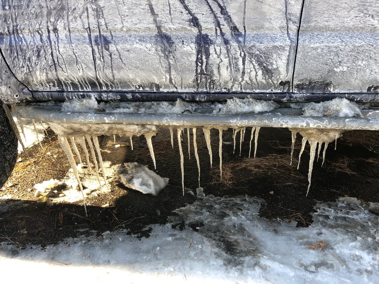

  9. Jan 6, 2018 at 12:05 PM
    MattJakobs
    MattJakobs Everything but a Tacoma
    Dec 12, 2014
    #144174
    7,309
    Matthew
    NorCal
    1985 4Runner w/ FlipPac
    Got icicles?
    4WALKER and dtaco06 like this.

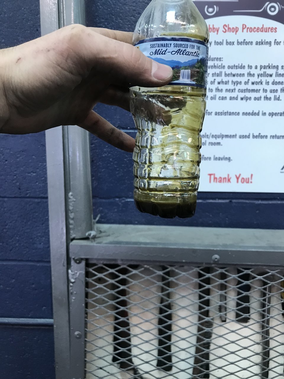

    I’ll join the party. I gotta pull my rear diff and change the o rings to stop getting oil in my air line. I pulled this oil from the line today.
    My locker wasn’t engaging and disengaging like it should before I cleared the line...

    Ya chase at ecgs said it was really common on our particular rear diff due to the design and sent me the replacement o rings for free but kinda a bummer. At least it’s the rear and not the front. Much easier to pull the rear.
