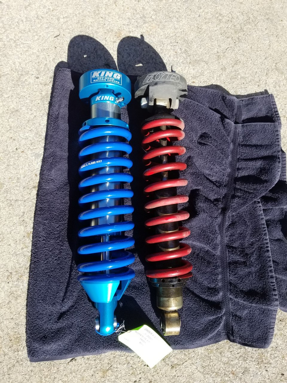

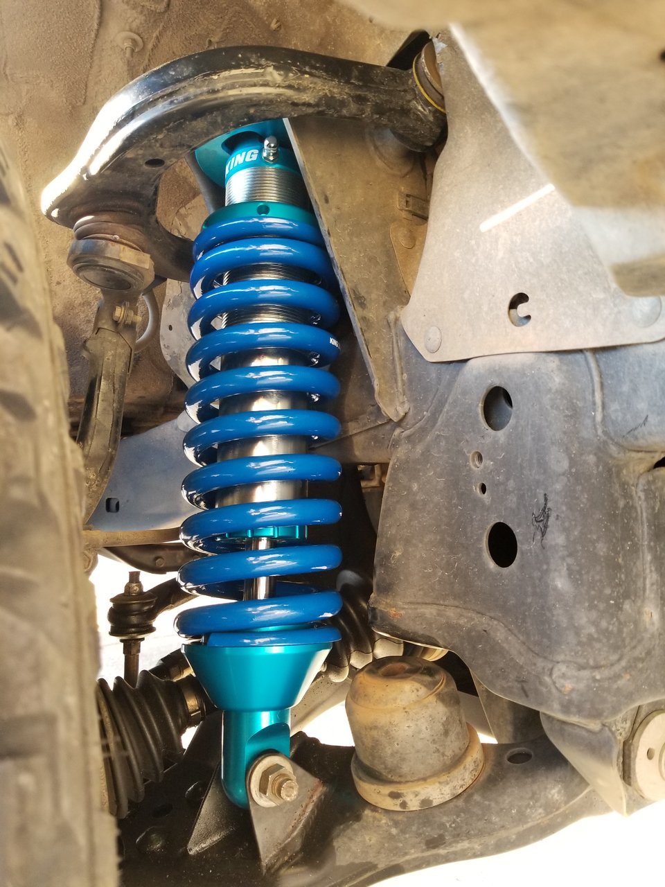

    Got the kings put in. They were almost impossible to adjust on the truck, and I couldn't do it off the truck with my little vise. I called DSM and they said they don't recommend adjusting on the truck, and you should put them on, measure, put them in a spring compressor, move the collar where you want it, and reinstall.
    So I installed them as is. I'm about 1 1/4" higher than I was before. Now I'm right at 23". I'll run them for a week, measure, and if they're still that high I'll throw them in a spring compressor and bring them down 1/2-3/4".

    You know how much preload you’re running?

    Right around 1.5" on each side, 14-15 turns.

    I made the exact same switch and I love my kings. My toytecs had so much preload I lost about 1/5" in height. With LC 8 wraps in the back I'm sitting like a stink bug.

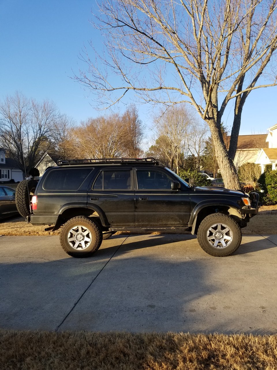

    Yeah so far in the 10 miles I've driven they seem to ride pretty good. I'll get a better feel for how they compare to the Boss ones after I drive on them for a little longer. I think mine are set too high. My inner CV boots are touching, and I only have .5" of rake. Next weekend I'll pull them and bring them down about an inch.

    You can try using some ratchet straps with them on the truck to loosen the spring tension a bit, and may be able to spin the collar.

    I hadn't thought of that. Unfortunately when I was trying to adjust the passenger side one I got it to turn just enough to where the Allen bolt is on the back and can't be accessed. I pulled the coilover, tightened the Allen bolt, and put them back in. Next weekend I'll pull them both, put them in a spring compressor and back it off 4-5 turns I think. If it needs more fine tuning from there I might give the rachet straps a try.
