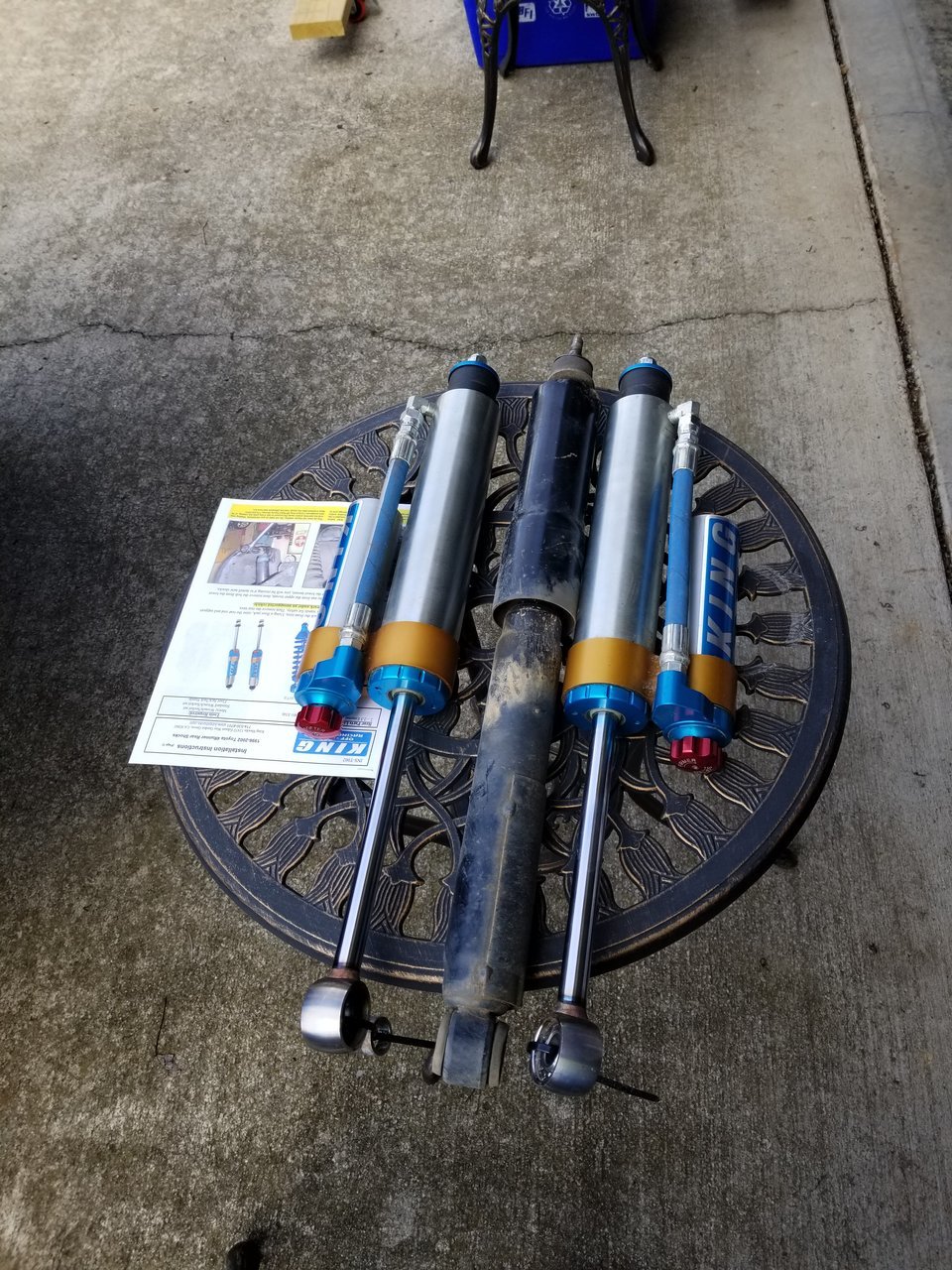

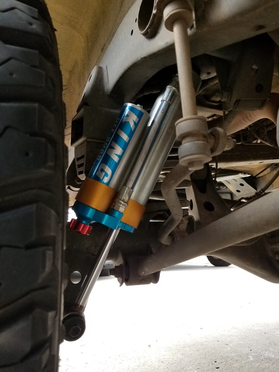

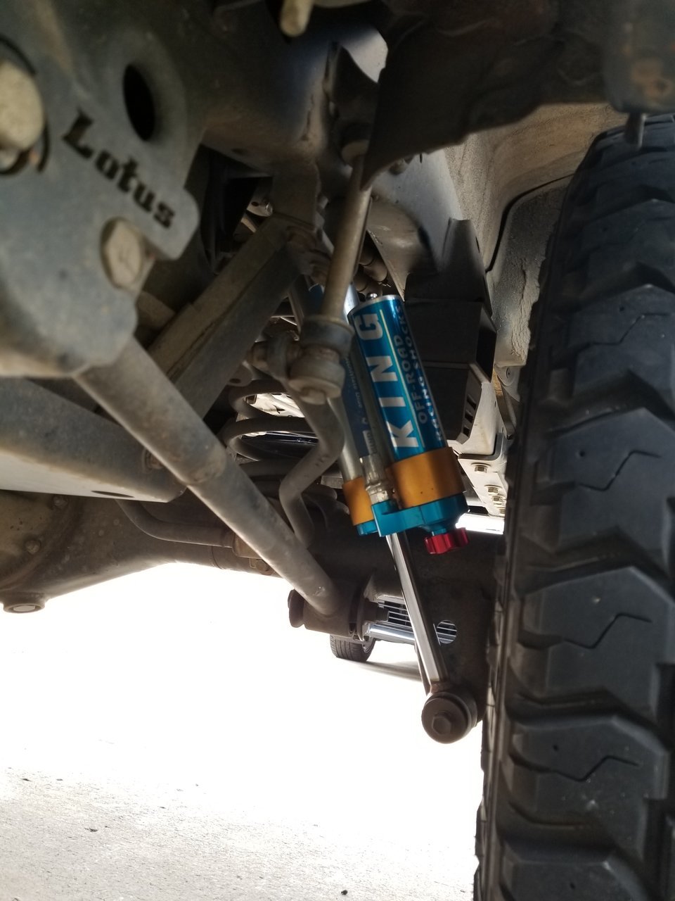

    Put the kings on this weekend. I'd say the majority of people install them wrong, leading to the majority of the issues...
    Most people install the passenger on the driver side and vice versa. People don't realize the shaft can be rotated to match the lower mount...
    I put mine on, went for a 20 mile drive and realized they rotated. Then I realized I tightened the top with the axle drooped so I retightened the top with the truck on the ground and they were fine for the 25 miles or so I drove. Then I decided to take it out on some dirt/gravel and see how it did. After 7 or so miles they rotated again, but not as much. I rotated them back and drove 3 more miles on dirt and 15 more on pavement. No rotation. I'll try to snug them up some more on the top mount if I can, but they're pretty tight already. I also might loosen the piggy back clamp, rotate the shock, and retighten the clamp. Maybe the shock just wants to be in a certain position?
    Anyway, the ride is amazing now. At low speeds around the neighborhood they feel the same, but at 40mph driving on the worst roads around here I didn't feel a thing. The front was rougher than the rear honestly. I was floored when I hit those huge pot holes at speed and the rear end didntd skip and hop and do whatever it wanted. I love the ride now. I have them set all the way to soft and I still feel less sway on the interstate.
    I pushed it pretty hard on the dirt and the entire truck did really well. That was the first time it has seen dirt with any of the new suspension. I'm very impressed. Especially with the rear. I didn't think it could ride that good.

    Very glad I got them. I wasn't sure they'd do that much for the ride in the back, but I'm sold. My drive everyday consists of driving over those roads and it was starting to get old. Now it's so much more comfortable. Just need to get the slight rotation figured out.
    Not a whole lot yet. So far all I did was max soft, and max firm. Max soft rides really good, max firm is much stiffer over the same roads the max soft soaks up. I plan to experiment around with them for daily driving, for loaded down with camping stuff, and when I just want to make a quick run without hauling everything with me. They're definitely worth it in my opinion.
