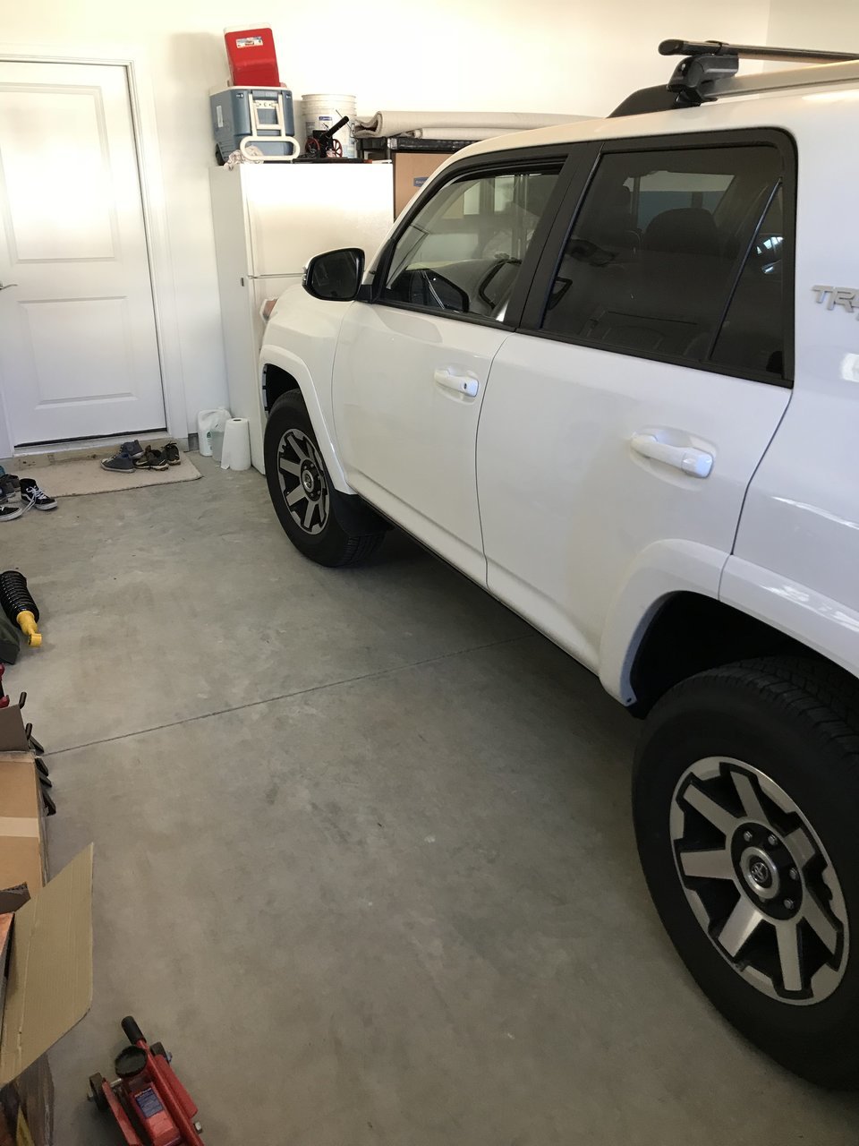

    Spent the day getting the OME suspension installed. She now rides like a 4Runner should! I have the height measurements in the Runner still but it’s time for beers at the local dive. I can unload everything tomorrow.
    Before.
    After.

    Here are my measurements. Taken with a full tank of gas, no cargo in the rear area.
    Driver front.
    Before: 34 1/2”
    After: 38 1/8”
    Gain: 3 5/8”
    Driver rear.
    Before: 36 7/8”
    After: 40 1/2”
    Gain: 3 5/8”
    Passenger front.
    Before: 34 3/8
    After: 38”
    Gain: 3 5/8”
    Passenger rear.
    Before: 36 3/8”
    After: 40 1/4”
    Gain: 3 7/8”
    I need to get an alignment because I do have some positive camber going ATM. I’m going to recheck measurements after 500 miles and see if there’s any settling in the springs.
    This is a KDSS equipped 4Runner and I did not do anything to the KDSS during the install. No removal of the sway bars from the lower control arms or rear axle and no KDSS calibration (back valves out and shake vehicle) and my measurements are well within Toyota’s specifications of .787 inches.
