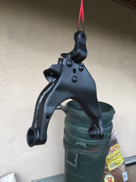

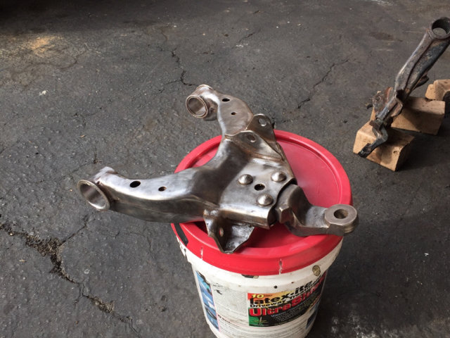

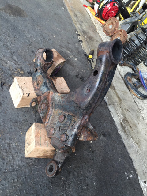

    Wire wheel and an angle grinder

    Did you have to rub it down with acetone or anything or just a lot of time sanding?

    After I finished wire wheeling, I did a quick wipe down with acetone, and then laid the primer on. No sanding
