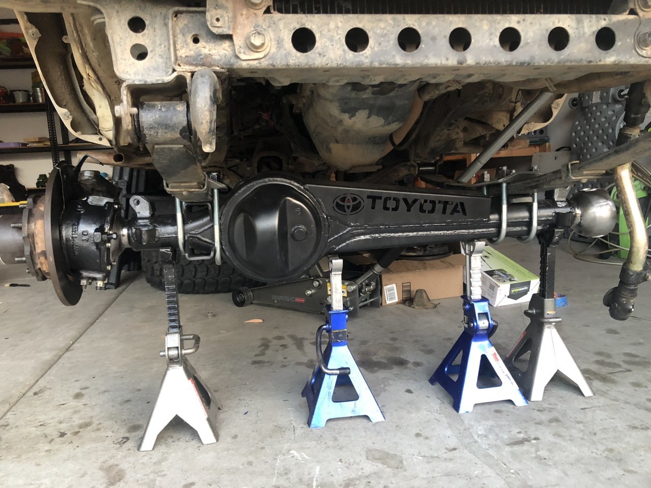

    Well got half of the reinstall done...until I realized my dumbass lost some hardware to the driver side knuckle :frusty:
    So now gotta order it probably won’t be here till Wednesday or Thursday next week...ah so close

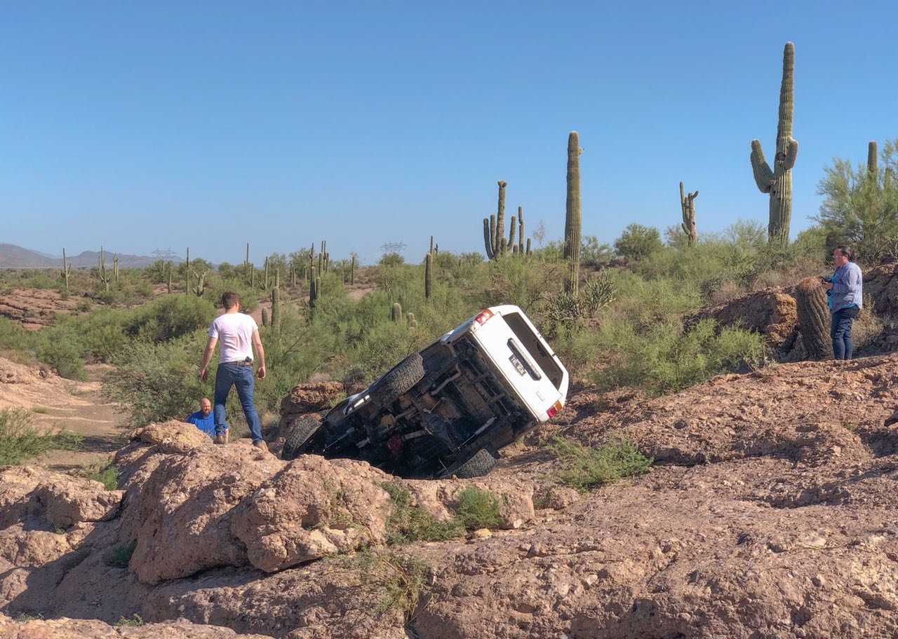

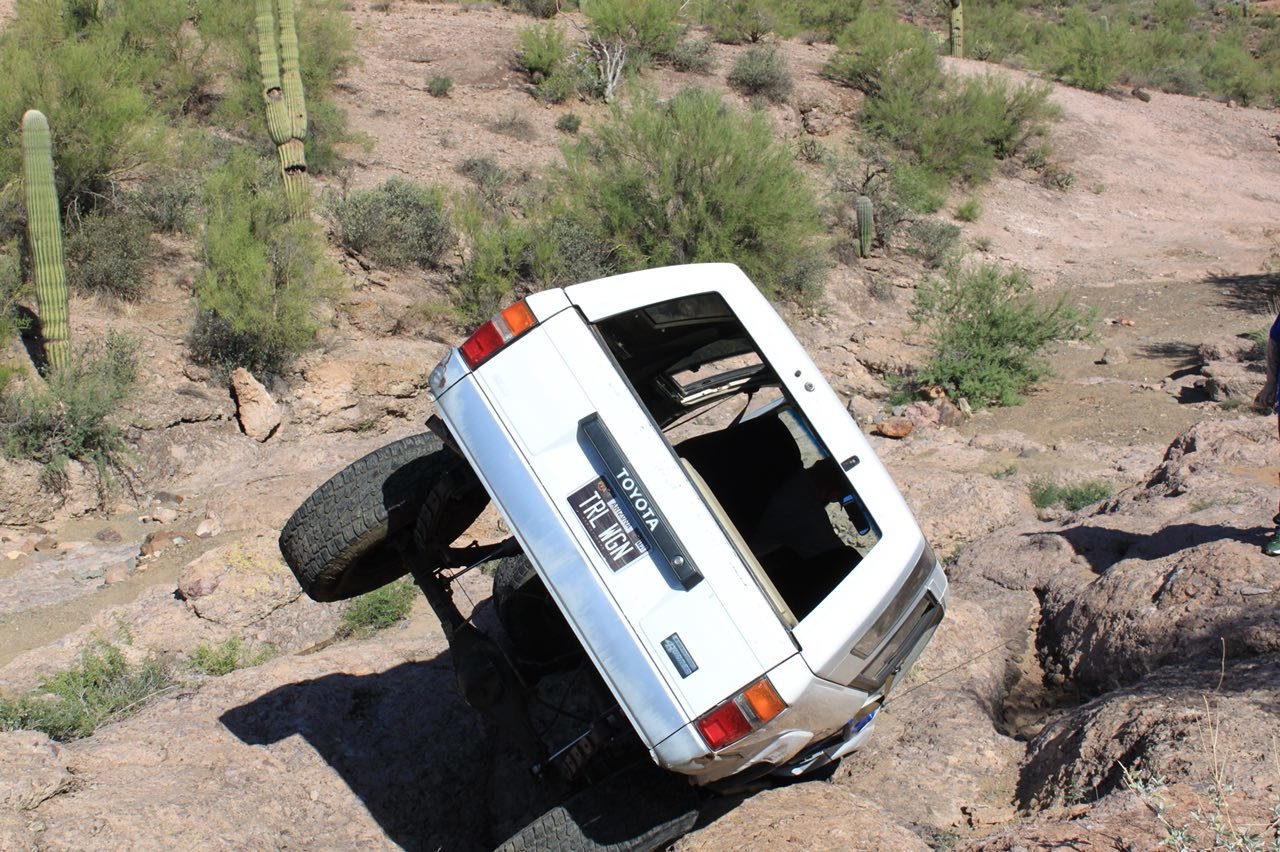

    Body didn't touch. Did eventually scuff the tube door.

    For sure. Flat right rear didn't help.

    Assembled the other knuckle, proud dad over here kid is almost 5 can successfully line it up and thread the bolts in. Guess letting him help a lot( read mess it up most of the time ) is paying off

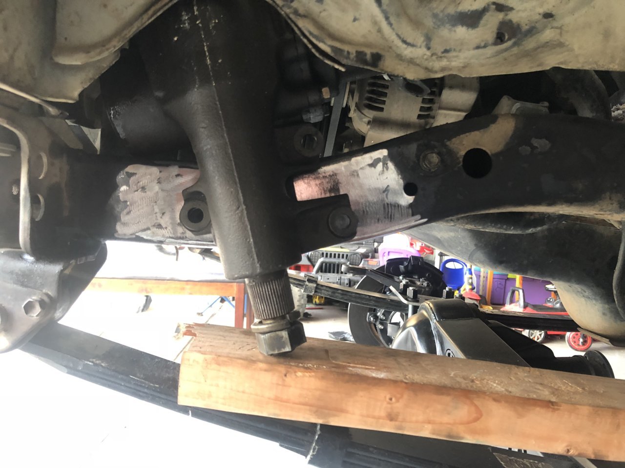

    Then got the new steering box mocked up after chopping old mount off, this goose is almost cooked:transformer:
    dtaco06, stumbles and RPS1030 like this.
  13. Sep 2, 2018 at 7:26 PM
    RPS1030
    RPS1030 Well-Known Member
    Oct 19, 2013
    #114792
    3,491
    Go further forward
    85straight[QUOTED] likes this.
  14. Sep 2, 2018 at 7:28 PM
    85straight
    85straight Mall-Rated
    Mar 9, 2017
    #212812
    396
    Al
    Menifee,Ca
    1985 4runner
    Forward as in towards the bumper?
    I’ve scooted my axle forward about 1 1/2”, if that makes a difference
    Keep reading to move as close to front of vehicle as possible , box is nearly touching front clip now
  15. Sep 2, 2018 at 7:30 PM
    RPS1030
    Oct 19, 2013
    #114792
    3,491
    Yeah, towards the front bumper.
    My axle looks to be shifted forward also ("Bag of Hack" I got recently).
    Old recommendation is to chopup the front body mount and/or rotate the box so the shaft is more vertical (flat pitman arm time).
  16. Sep 2, 2018 at 8:01 PM
    85straight
    Mar 9, 2017
    #212812
    396
    Al
    Menifee,Ca
    1985 4runner
    Rotated the box so the shaft is straight with the steering shaft, then went a tad higher. Then pushed box all the way till the back of the box contacted front clip.
    What issues will run into if I don’t cut into the front clip anf make more room to shift the box farther forward?
    I though I had it pretty good, but this is a first for me
  17. Sep 2, 2018 at 8:09 PM
    RPS1030
    Oct 19, 2013
    #114792
    3,491
    With some compression the drivers side, the pitman arm/drag link will contact the tierod. Potentially prevent steering across center (right to left of left to right). Really sucks on a tough spot.
    Mine is overlapping enough, there might have been some severe binding at other points of the steering today.
  18. Sep 2, 2018 at 8:23 PM
    85straight
    Mar 9, 2017
    #212812
    396
    Al
    Menifee,Ca
    1985 4runner
    Then a flat arm and possible notching the frame would be the solution right? Don’t wanna go down that road but I’ve seen that a few times too
  19. Sep 2, 2018 at 8:25 PM
    RPS1030
    Oct 19, 2013
    #114792
    3,491
    I think the flat pitman is usually for rotated boxes to avoid dropping the drag link to much. Should be able to get by without notching the frame.
