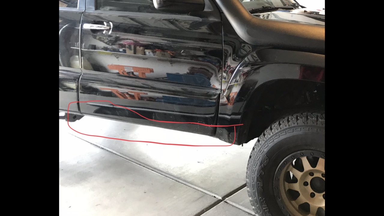

    Did that on my XJ when I had it, worked well but was a pain in the ass to do welding sheet metal.
    May work on 3rd gens but I don’t see you gaining more then an inch of clearance and I don’t see it being worth it
    4th gens it wouldn’t work on because the bottom of the door wraps a round the bottom of body 84236181-3EB9-4D3C-855D-7528580A1009.jpg

    If committed to clearance, trim the bottom of the door and raise the sill/floor. Create a tub.

    I have no desire for that at all, just pointing it out as a reason it probably hasn't been a trend on runners

    I can't quite wrap my head around how you would do this with a body of frame. You'd have to tie it into the frame with some sort of bushing mount that will still have to flex a bit with the body on bushing mounts, but yet strong enough to take the brute of the impact of rocks without lifting the body off the frame by the factory body mounts.
    Or does that mean you turn it into a boat side like they do for jeeps?

    Yup, solid mount body and give up the bushings.
