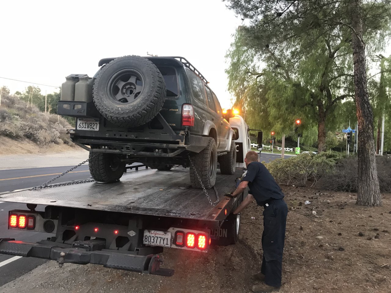

    Made it to the tow truck now to order parts...

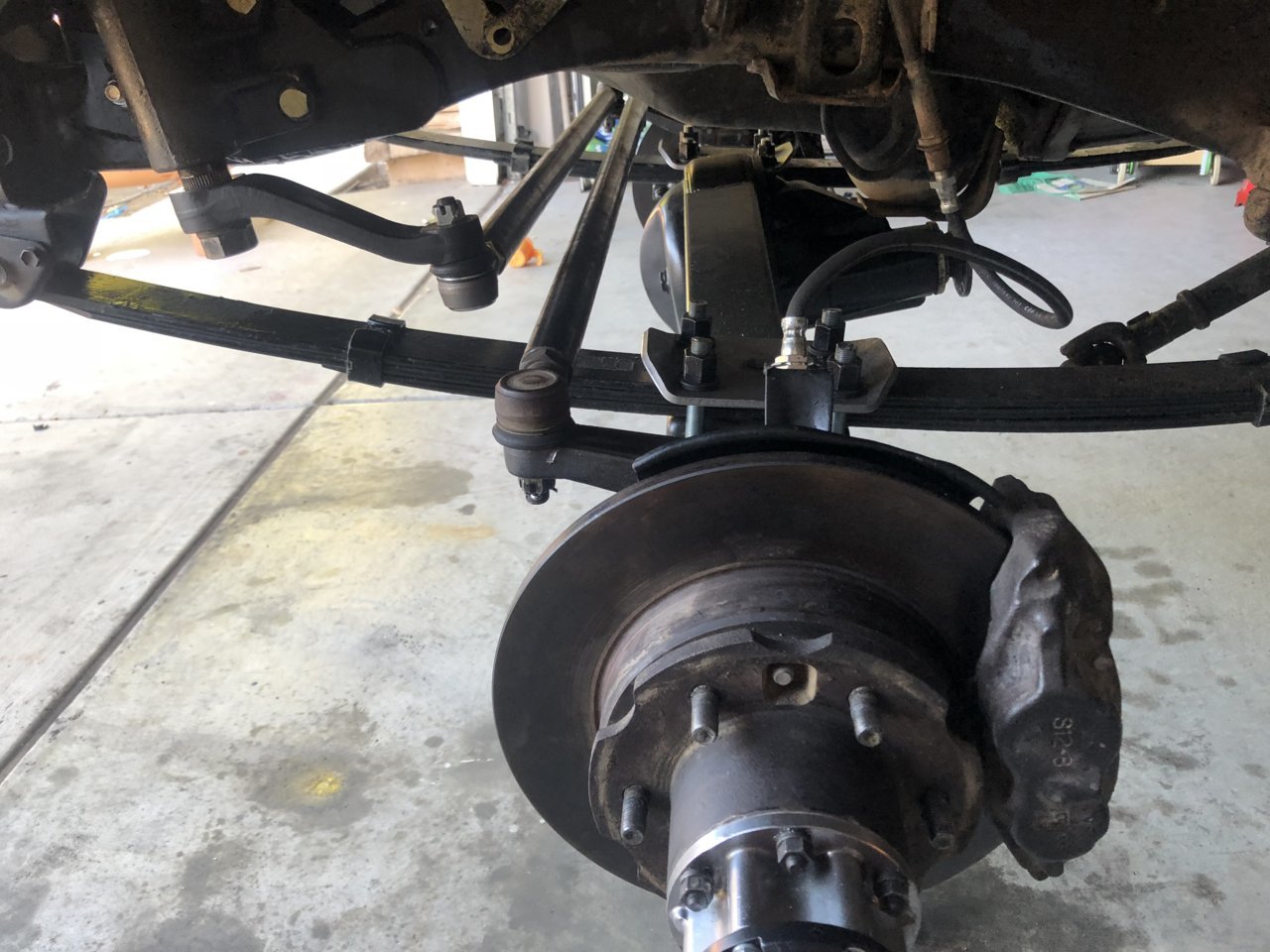

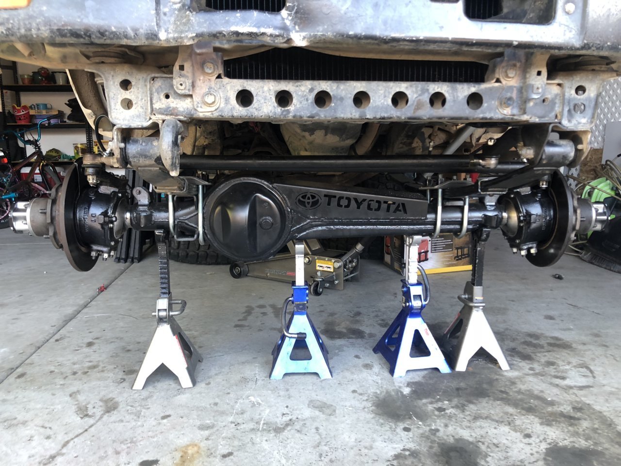

    Finally ready to put the dam tires on the ground and check my toe
    Ended up repositioning the box after @RPS1030 gave me a heads up, thanks dude

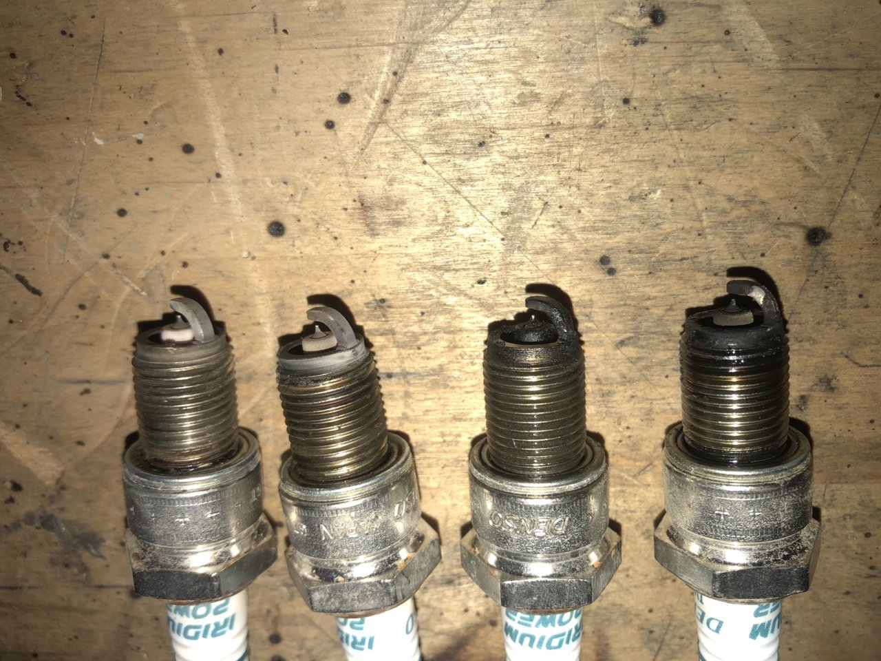

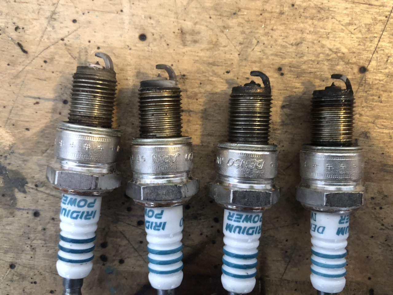

    Got the tires on the ground and set the toe
    Now onward to my dam engine woes
    Starting simple again after chasing this crap for ever
    Timing is good
    Valve lash is good
    About to go rent a compression tester
    Here’s the plugs cyl 1-4 left to right
    3 and 4 not looking too good, pretty caked with oil.sooooo I’m sure I’ve got blown rings or a bad valve seal

    Well I’ve known this, just want to nurse it along until I can swap it out next summer when I have the funds
  11. Sep 16, 2018 at 7:36 PM
    theesotericone
    theesotericone Well-Known Member
    Jul 27, 2018
    #260800
    12,395
    Bishop CA
    Throw some new plugs in it and drive it till next summer. I had a 22re in my old Toyo van with 335,000 on it. From 235,000 to 335,000 three of ,my plugs where oil fouled every time I checked. I'm sure it was the rings and I'm sure the compression was shit but it kept running. It's a pretty gutless motor to begin with so loosing a little power was no big deal.
    85straight[QUOTED] and dtaco06 like this.
