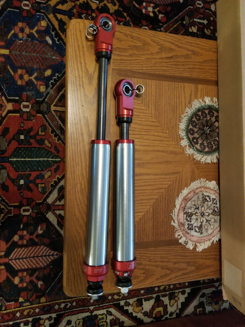

    This is probably a stupid question, but at this point I'm second guessing myself... My dad ordered sway a way suspension for his FJ. 2.5 coilovers up front and 2.0 shocks in the back.
    The first set of rear shocks I thought something was wrong. The one shock can be easily collapsed by hand and the other takes all my weight(200lbs) to get it to collapse. The shock that is easy to collapse does not extend itself. It will stay collapsed for days. The other rebounds immediately. I thought this was a faulty shock so they sent him another set.
    This set does the exact same thing. I took this picture after they'd been sitting on the table for 20 minutes and it stayed in that position. That shock should have rebounded and extended itself, right?
    I'm thinking they didn't charge them with nitrogen, but it's kinda crazy it's been the same issue on 2 sets of high end shocks...

    Thanks. I needed someone to confirm haha. I can't believe 2 out of 4 shocks have been bad out of the box. That's awful considering this is like an $800 kit...
    At least they didn't make him send the other kit back yet so he can take the good shock that came from each kit...

    Yeah, luckily we installed the coils already so he couldn't return the kit without them sending a new kit first.

    They don't have the nickname stay-a-way for nothing.
    Check the pressure in the shock. Call them and ask what the recommended pressure for your dads set up is. Compare the two numbers. It's either low on nitrogen or there's a leak allowing air passed the piston
