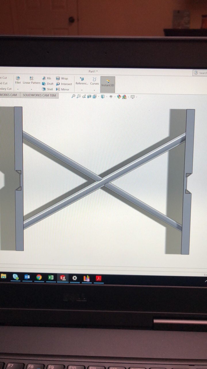

    4Runner is being chopped up. Ordering a lot of shit. Most expensive is my giant list of tools I now own. Recently added a TIG and a plasma cutter :rofl:
    Soon it will have a crawl box, 14” ADS coilovers, full float 80 axle, and a large fuel cell

    Pretty much exactly my plan. Cut the floor out, throw an X brace across the frame rails in the back. Build a fuel sell mount off of that. And build a hump hatch of the whole thing with some door sealant on the edges.
    Probably go for 22 gallons or so

    I didn’t see any benefit in going to 16’s over 14’s. I like 14’s because they’re the max length of shock for Ultra4, which means I can keep these shocks for future builds. And ya I’ll cut out the whole cargo area and start fresh
    Frame notch for coilovers, cross bar across frame rails. Mount fuel cell on top of X. Make access hatch

    Sweet! So what are the shocks mounting on, a tower, hoop connecting them? If/when I get to something like this, I was thinking towers with a brace either against the seat backs or maybe up to the roof.

    Ya they’re coilover towers. I want to brace them, but haven’t decided yet. Realistically I have air bumps as well. So I’m hoping the towers don’t see too much force

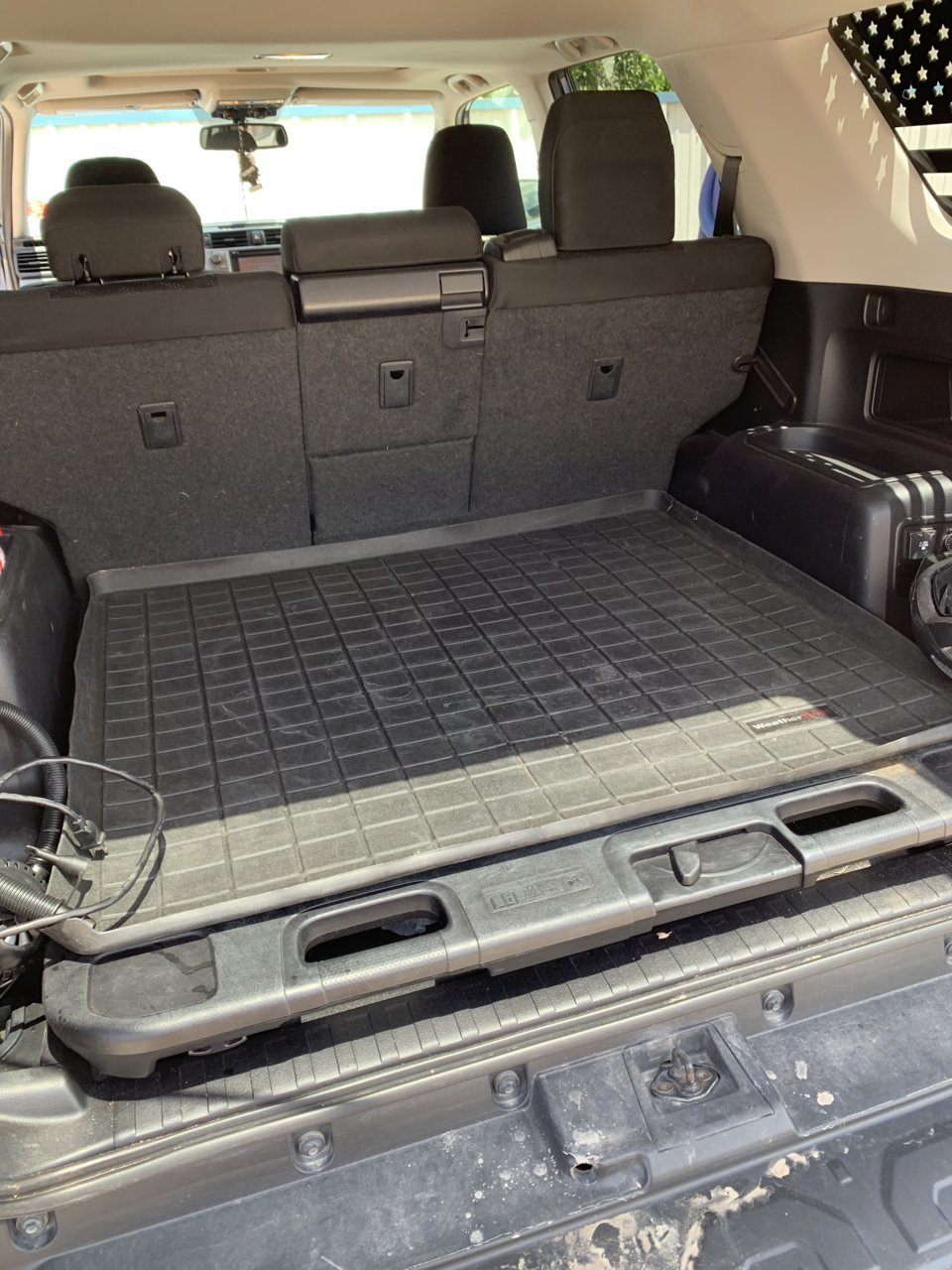

    Needs some armor all. But picked up a full set of weather techs and the cargo liner for $100 locally. Steal. Seat covers next.
    AlitasPride likes this.
