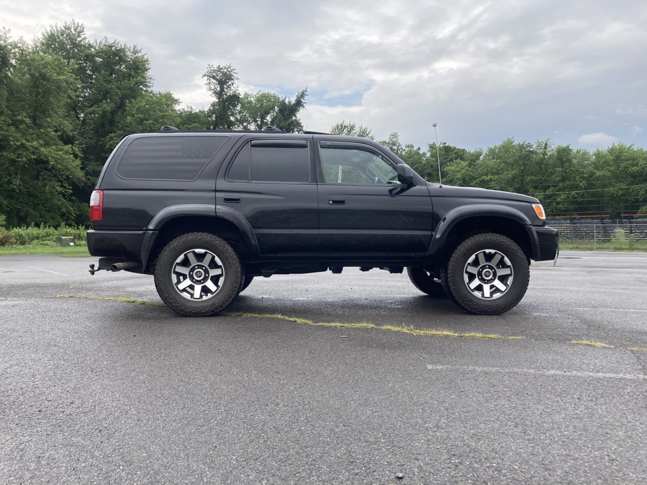

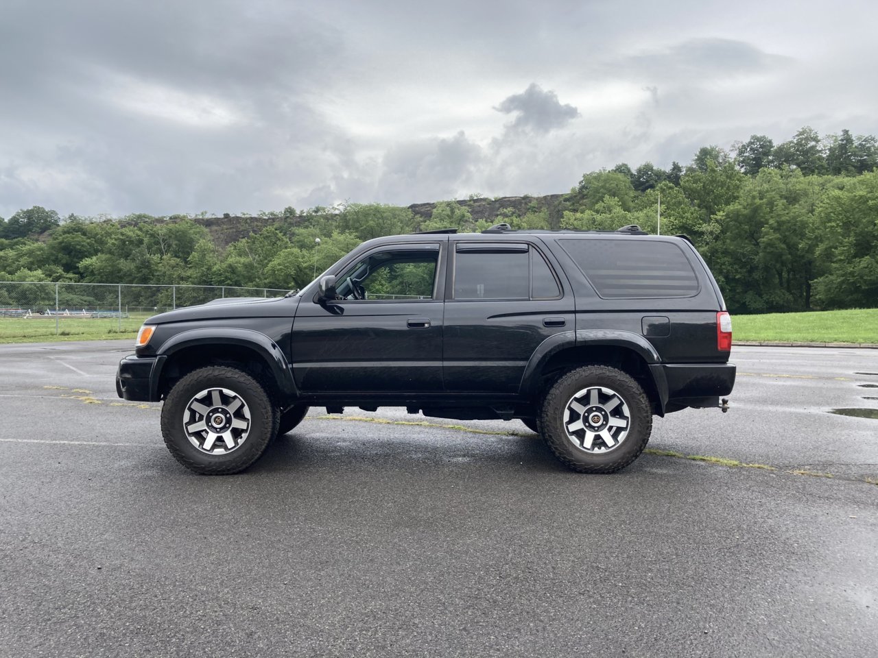

  13. Aug 6, 2020 at 12:57 PM
    AR15xAR10
    Apr 13, 2013
    #102024
    56,921
    2013 TRD Sport 4x4 V6 ACLBFTMFW
    She’s definitely a little saggy in the booty department:
  14. Aug 6, 2020 at 3:01 PM
    BuzzardsGottaEat
    BuzzardsGottaEat Well-Known Member
    Apr 27, 2011
    #55669
    8,577
    Some Toyotas
    Round tires
    Looks clean otherwise! Let me know when you’re ready to sell :D
