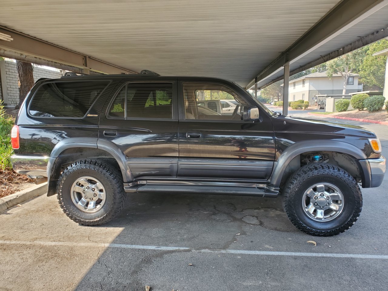

    OME906 are nice progressive coils that gave me just under 2" in the rear and no spare tire and stock skids; they're meant for stock weight.

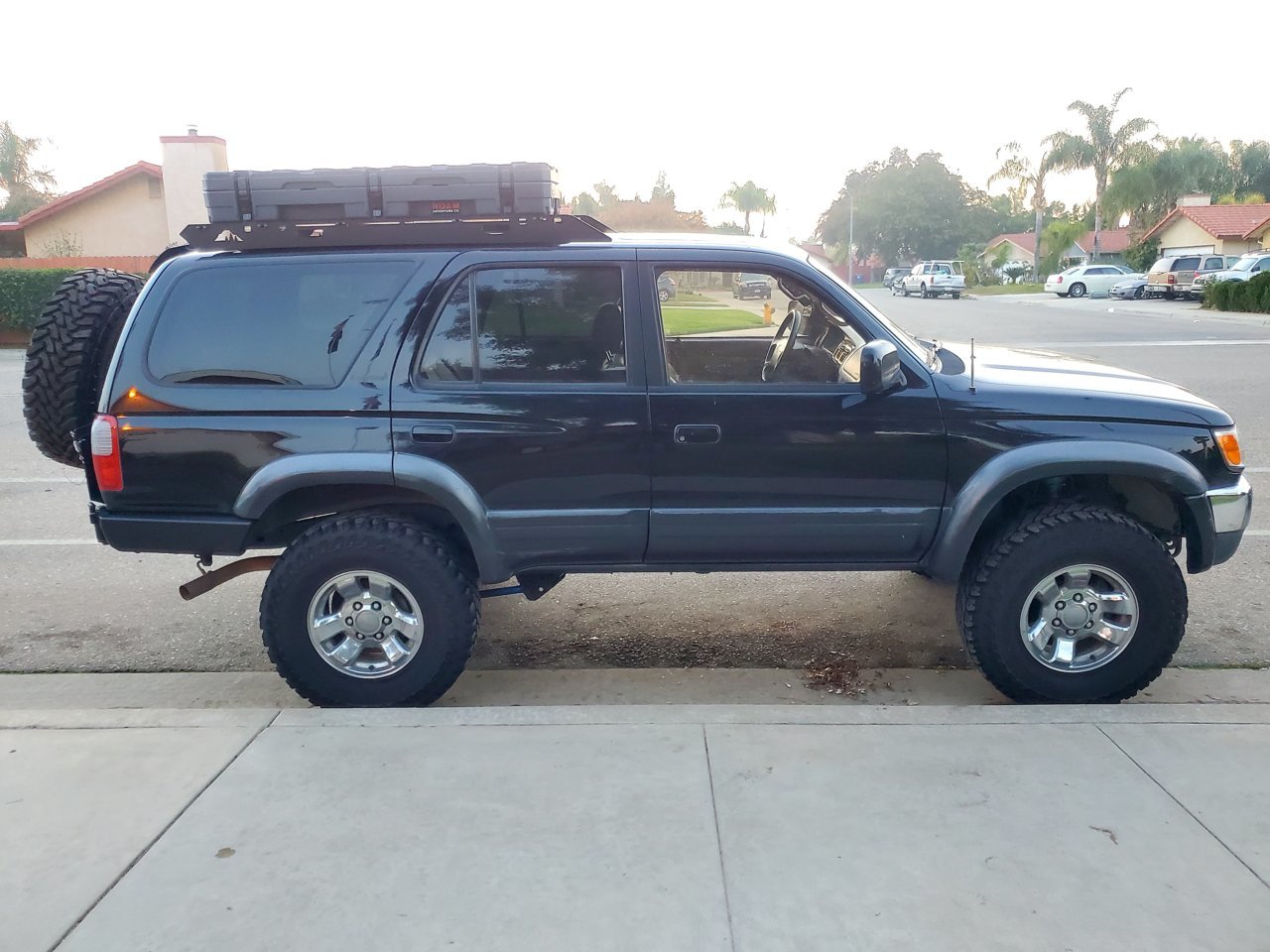

    This was last year before adding my swing out bumper and the 906's -
    @Tour991 now has them as I moved up to OME890 due to the added weight.
    Since adding exterior storage, full camp gear, and our 65lb fur child, I may move up to Superflex coils.
    Here's how it sits at the moment with extra weight and the 890's -

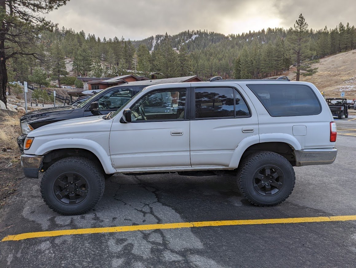

    @Dalandser here is how my 99 is sitting on the OME906 that I got from @Kwikvette. I am running Icon 2.0s with them and am on 265 75 16s

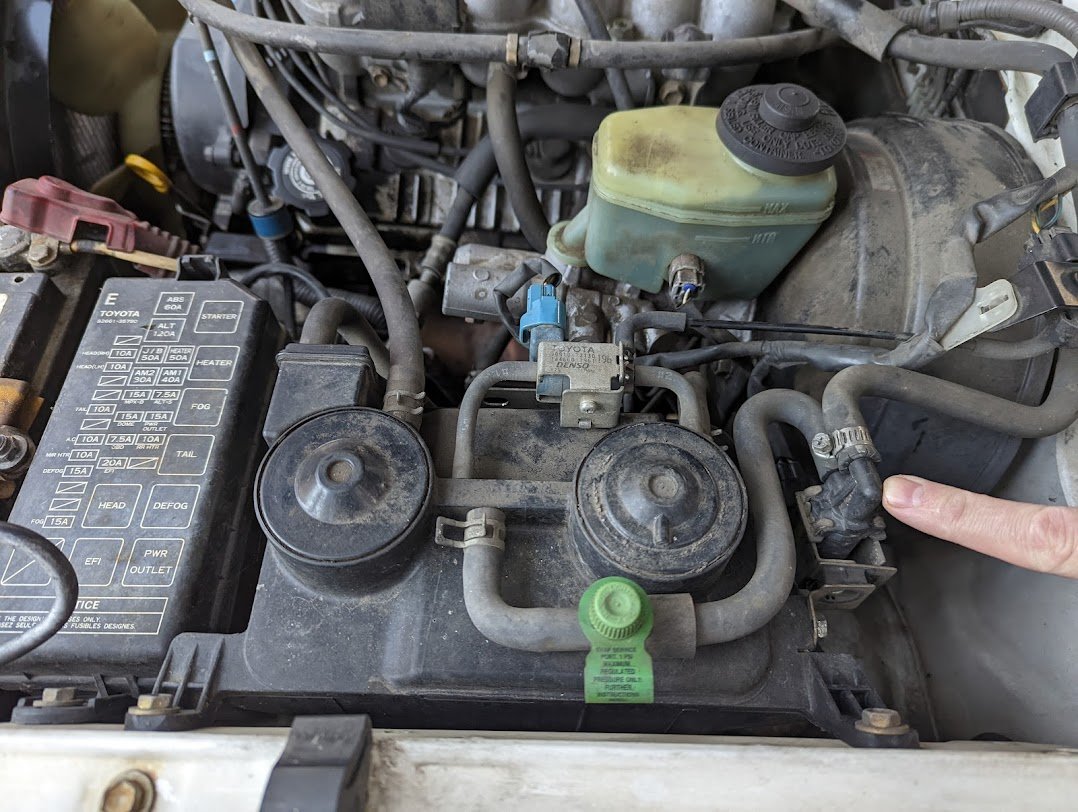

    Any one ells have a ticking sound coming from the evap system on their 3rd gen? I here its normal on some but is there a way to fix this?
  13. Dec 5, 2021 at 3:33 PM
    Dalandser
    Dalandser ¡Me Gustan Las Tacos-mas!
    Feb 19, 2015
    #149090
    17,674
    Anthony
    Downey
    08 PreRunner Regular Cab / 98 4x4 Extra Cab
    Empty Wallet Mod
    Is yours in the engine bay?
  14. Dec 5, 2021 at 3:42 PM
    Tour991
    Tour991 Supplier of used parts
    Nov 24, 2011
    #67616
    11,046
    James
    South Reno/Tahoe
    97 2/4wd, 2014 DCLB 4x4, 99 T4R Limited (sold) 2024 4runner TRD Pro
    yes
  15. Dec 5, 2021 at 3:44 PM
    Dalandser
    Feb 19, 2015
    #149090
    17,674
    Anthony
    Downey
    Empty Wallet Mod
    Interesting - sounds like the solenoid is malfunctioning?
  16. Dec 5, 2021 at 4:27 PM
    Tour991
    Nov 24, 2011
    #67616
    11,046
    James
    South Reno/Tahoe
    I swapped out this valve felt a pulse in it but the newish one is doing the same thing

    Might want to put a multimeter backprobe and see if it’s getting a weird pulse signal although that might only respond to pressure
