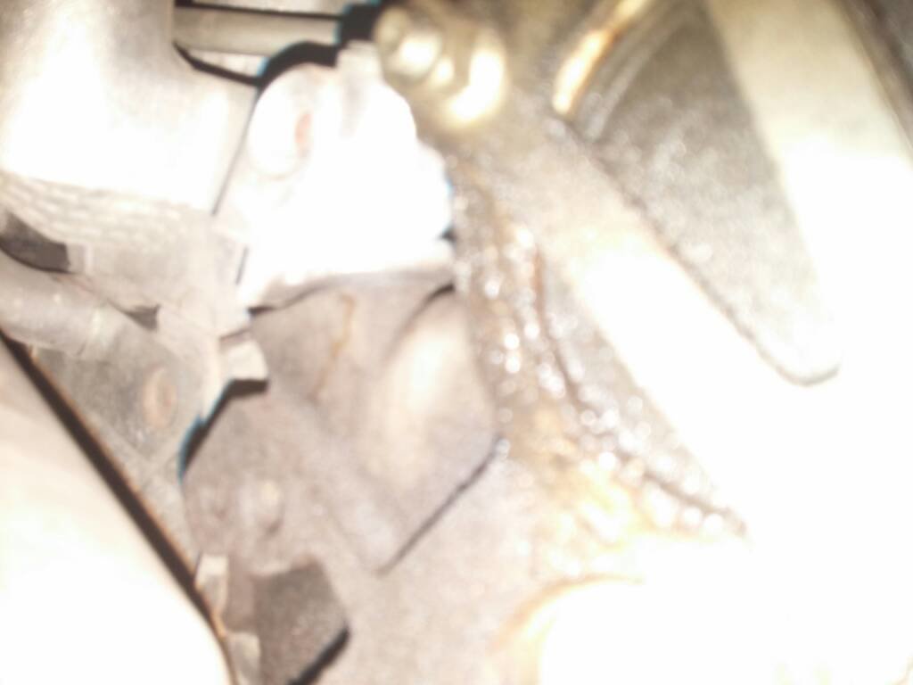

    Bummer! Looks like an ape, or animal without thumbs put the gaskets in my vc.
    Odyssey. I have one now. Cranks hard at -30 I have the seats die-hard platinum version. Silver looks better than orange.
    I can indeed elaborate.
    Half moon plug
    Shorty cell phone, around back of engine pick of full plug 64d8ea03657cf3b9141a4b4886fb2036_fd2e15d45eed5373c8b9671623f3ce6a3c895192.jpg
    The deal is, each side has two half moon and one whole plug.
    The half moon plugs are aluminum. Pull with pliers and replace with gasket sealer.
    The full plugs are plastic and metal and get replaced. I will get better pictures later. Trying,to find my mini steel brush.
    So far the "hardest part was getting the spark plug grommets out. They broke in two pieces and it was hard getting the remnants out without scratching the valve cover. I am just doing the passenger side tonight.
    I am having another electrical problem 100% caused by me washing the engine. I am hoping two birds one stone.
