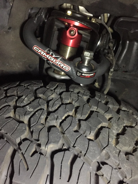

  10. Mar 24, 2016 at 6:53 PM
    rjsimz
    rjsimz Well-Known Member
    Nov 29, 2012
    #92098
    3,243
    Rob
    Huntersville, NC
    13 4x4 DCLB
    Fucking done.
    I'm sitting 1" higher in the front than the back. I'll be adjusting them accordingly when my back stops hurting.
    But of course when something good happens...something else pops up. Passenger LBJ's just started leaking grease today. If it's anywhere close to being as bad as the uppers, I'm gonna go crazy.
  11. Mar 24, 2016 at 7:06 PM
    4WALKER
    4WALKER Save the manual trans!!!
    Nov 9, 2015
    #169102
    2,068
    1991 4runner 5 speed SR5 4X4
    Dirt
    Congrats bro.

  13. Mar 24, 2016 at 7:38 PM
    ramonortiz55
    ramonortiz55 [OP] Not A Well-Known Member
    Nov 28, 2012
    #92013
    35,260
    Ramon
    Texas
    2015 DCSB Offroad 4x4
    stock
    howd you get it in?
  14. Mar 24, 2016 at 7:42 PM
    rjsimz
    Nov 29, 2012
    #92098
    3,243
    Rob
    Huntersville, NC
    13 4x4 DCLB
    freezing, mobil one grease, press, hammer, press, more hammer, press, and hammering the snap ring in.

  17. Mar 24, 2016 at 7:58 PM
    SCRunner12
    SCRunner12 Tundra Troll
    Aug 8, 2011
    #61363
    9,115
    Robert
    Santa Cruz, CA
    2006 Tundra DC, TRD, 4wd
    Congrats man! Really makes you debate ever touching your truck again.
    LBJ's are basic, I would use the 3 jaw puller again, they are simple to remove and install.
    rjsimz[QUOTED] likes this.
  18. Mar 24, 2016 at 8:02 PM
    rjsimz
    Nov 29, 2012
    #92098
    3,243
    Rob
    Huntersville, NC
    13 4x4 DCLB
    Any suggestions on where to snag a pair? Thoughts on moog? I know OEM is best but some moog parts are worth the money.
  19. Mar 24, 2016 at 8:22 PM
    ramonortiz55
    Nov 28, 2012
    #92013
    35,260
    Ramon
    Texas
    stock
    how big of a 3 jaw puller? i used a picklefork last time..just exploring options
  20. Mar 24, 2016 at 8:26 PM
    SCRunner12
    Aug 8, 2011
    #61363
    9,115
    Robert
    Santa Cruz, CA
    OEM all the way. I had moog and they sucked big time. They seized up (I greased them every oil change) and had little to no movement to the ball joint when I removed them after 25k. It was a VERY noticeable improvement in steering when I switched to OEM. I'll give you my old Moog if you want, but I wouldn't use them for anything but trail spares.
    I used a pickle fork my first time and that works great as well. I had a 1.5 ton puller and it works, but I also wasn't pulling apart one that was on for 200k.
