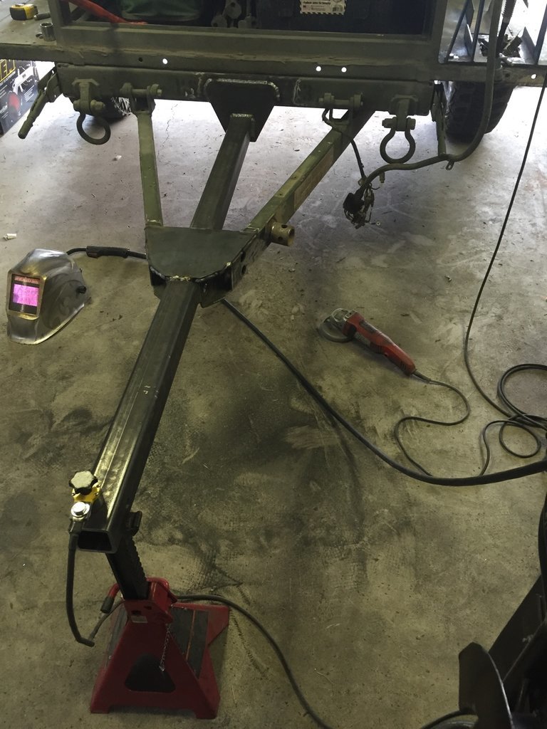

    That came out pretty cool!

    I wish I was a better welder. End of the summer I bought a welder so I could start practicing. I might check into a class at the local Community College next year.

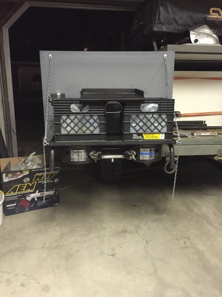

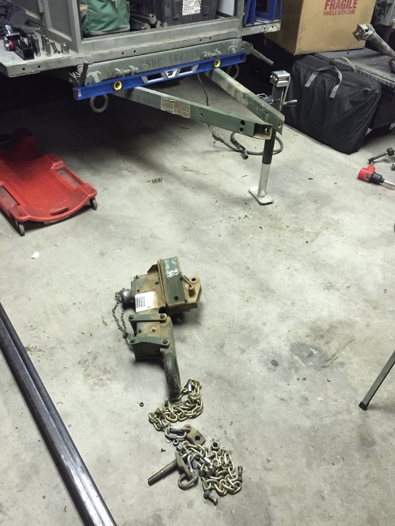

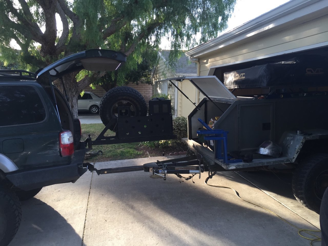

    Ya everything turned out pretty good. The trailer started as a flat deck and we built it up.
    The stove in that pic wasn't finished. It folds up and has a shelf above it.
    I wish I could weld too.

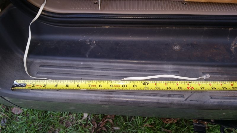

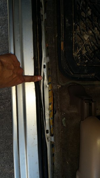

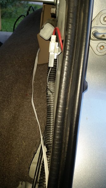

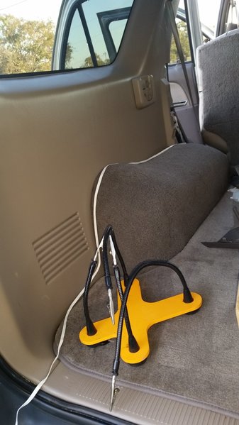

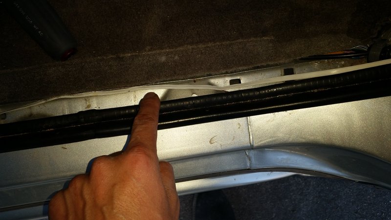

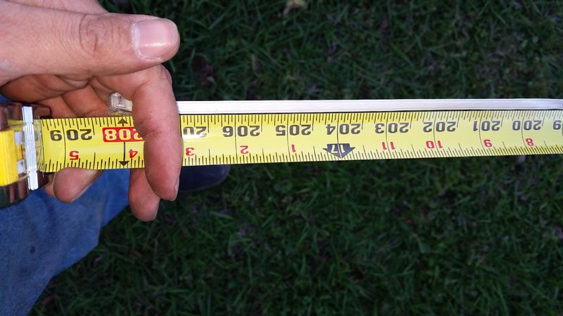

    So I measured out the distance needed for the coaxial cable..

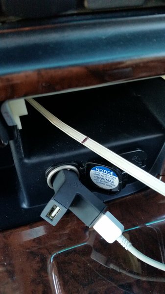

    Removed the ashtray and fished string thru a back opening. Notice that mark? That's the mark I measured from after I layed out all the string.

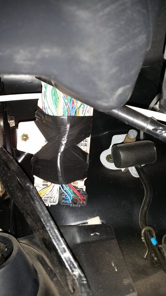

    Ran it behind this taped up wiring on thw drivers side

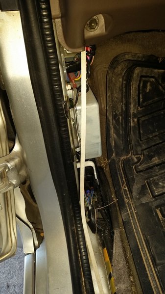

    Then i removed th left kick panel and ran it beside the 4x4 module thingy machig
    Removed the floor trim and ran it down there
    Then I ran it the same way in the back
    I removed more paneling and ran it up towards the rear wheel well in the back cargo area
    Didnt feel like removing that rear panel off
    Had about 18" left over to drop down and coil up to the antenna holder

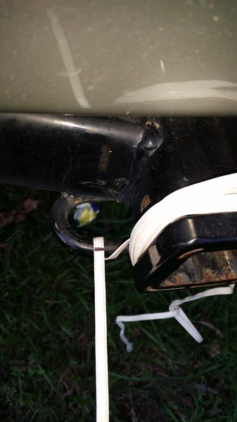

    Then i marked the string as shown on the first picture, tied it off at the hitch and measured out
    Looks like 17' - 4"
    18' should be good to go.

    I think I'd go with an 18' footer...but that's me! :spy:

    Thanks @ramonortiz55 for measuring that all out. I have also seen people run the cable through the center console which is what I am thinking of doing.

    You welcome! I already bought the 18' coaxial cable. The one with the fire ring.
