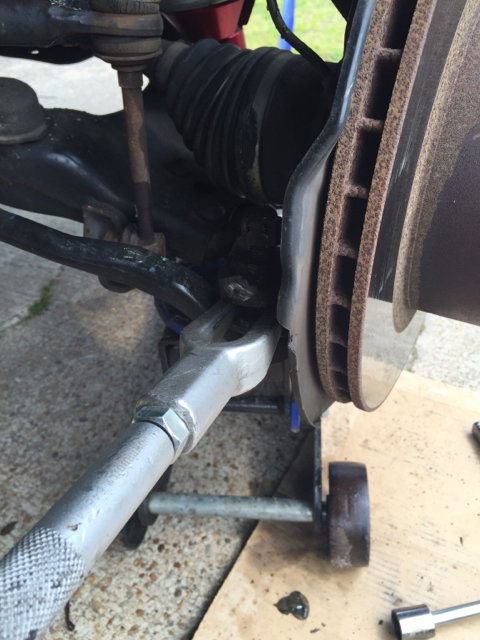

    Hammer isn't working. Pickle fork on the OTRE or two jaw puller?

    Using a 3lb and striking pretty damn hard

    Going pickle fork

    What am I doing wrong here?

    nothing, looks like the nut is loose so it wont swing wildly off when you finally break it off the spindle. Id hammer around the spindle arm and on the nut, but only when the nut is flush with the top of the TRE stem.

    remove the wheel, pop the cap off. take off the cotter pin and put wheel back on with 3 nuts. lower so its on the ground enough so it wont spin. Zap the nut off.

    Looks like I have to buy a new TRE. Fucked the boot up using the pickle fork. Haven't gotten it out yet. I haven't heard of anyone having so much problem getting this bitch off. Nothing is ever easy!!

    I was able to get mine off 10lb co2 tank..

    i never use a pickle fork unless i plan on replacing that said item. It always destroys the boots.

    Or have someone push the brakes in while you're breaking it.

    Or just have someone stand on the brakes. The nut gets torqued to 170lbs I think so shouldn't be much tighter than that. Yes a dewalt cordless impact makes it a cinch.
    Also I never use a pickle fork for that reason. I always use pullers. Cody just bangs it with hammer.
