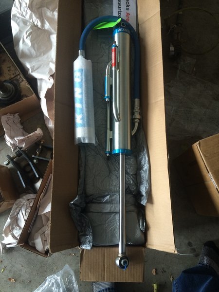

    It would still work with your top mount the way it is. The plate off the frame that supports the upper mount is the side you would have the resi hose. Keep in mind that with bypass shocks, the resi hose comes off the BOTTOM of the shock, not the top like smoothbodies. You would just need extended hoses.
    Some shock porn for ya:

    Sweet, yeah I knew about the resi coming off the bottom. Where are you going to mount the resi, and when does the 4R go under the knife?

    Ummm. The shocks came in yesterday...and they are being repurpsed for a different project for now.
    The resi was going to go to the top corner of the frame similar to where yours is, but not as far rearward.

    Haha, trailer LOL? Also, why no bottom out bumper and plate?

    Because bump stops. The rod end pictured is a welded rod end instead of threaded. This allows the shock to have a shorter extended/compressed length but still allow for 12" stroke.
