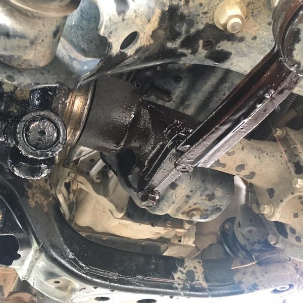

    My next thing. Noticed leaking last week

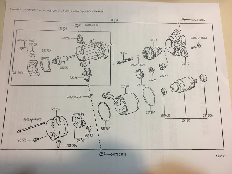

    Don't get an Autozone starter. Get a rebuild kit from Toyota. Just swap the contacts and the plunger

    this is what im gonna do with the older one.

    Did you get your plunger from toyota? I can find the contacts but I can't find any info on where to get the plunger

    Got the plunger off Amazon I think. Worst case, buy the Autozone starter, pull the plunger and contacts, swap them into yours. Put the old parts into the autozone one and return it hahaha

    28235-54380 (Plunger, magnet switch)
    28226-54340 (Kit, repair service)
    28226-72010 (Starter Kit)
    MattJakobs likes this.
