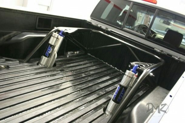

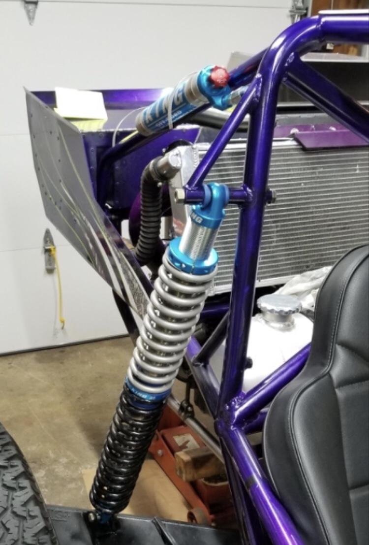

    Okay--after a lot of thinking, here is a photo for reference of how I'll do my bed cage. The only difference is that it'll be tighter with the bed and the shock will be on the outside.
    You can see how the double sheer shock mount setup will be as well in both photos. Purple buggy for more detail.
    Nicklovin, LukeCC and 04taccoo like this.

    No more shock hoops?
    Decided full / low profile bed cage?
    This is about where your shocks should end up:

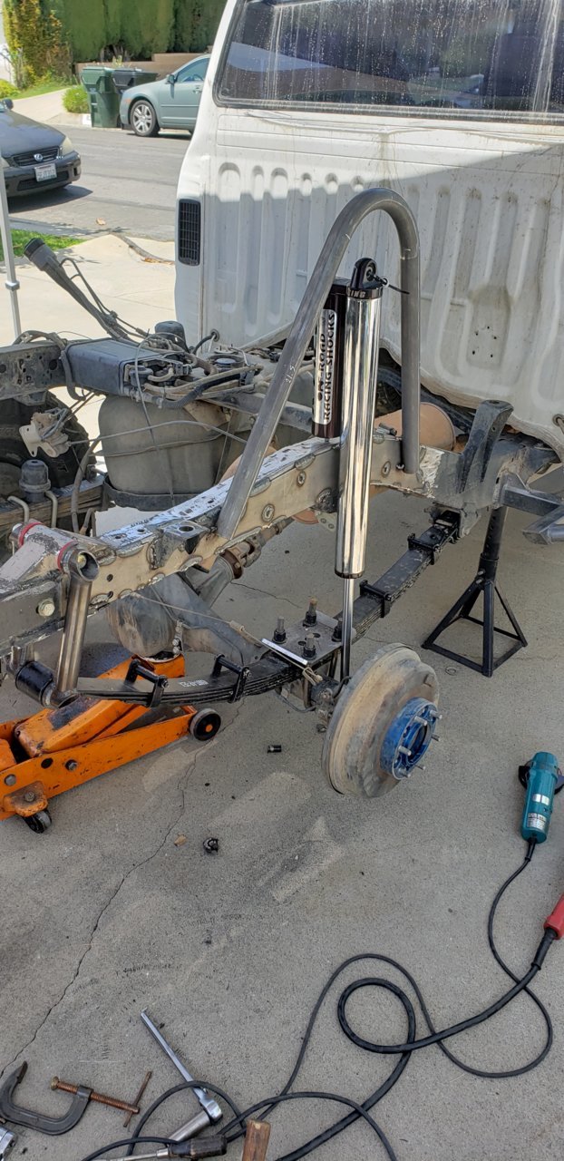

    Are yours inboard or outboard of the frame? I will be running the hoops, but instead of mounting them off of tube ends they'll be welded directly on top of the frame to eliminate flex and the shock will be mounted directly to the side of the hoop, hence the double sheer setup.

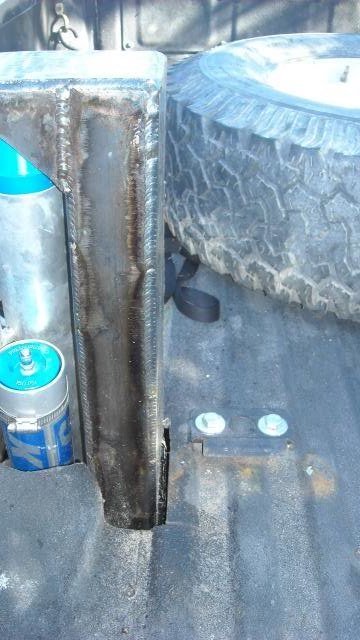

    This was taken from @Anthony250 's truck with shocks outside of the frame.
    He put a cross member between the towers later:
    When asking him about optimal angle for shocks I think he said 10-15* at full bump - not sure if that applies to soa as well, but I would think the shock will roughly perform the same in your case.
