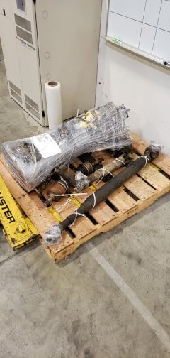

    Arrived at my work yesterday (a lot cheaper with freight if I have shipped to a dock). Inchworm box should arrive tomorrow hopefully. I feel bad for our UPS lady- Half of her entire truck is probably full of steel cross-members, differentials, and transmission parts hahah.

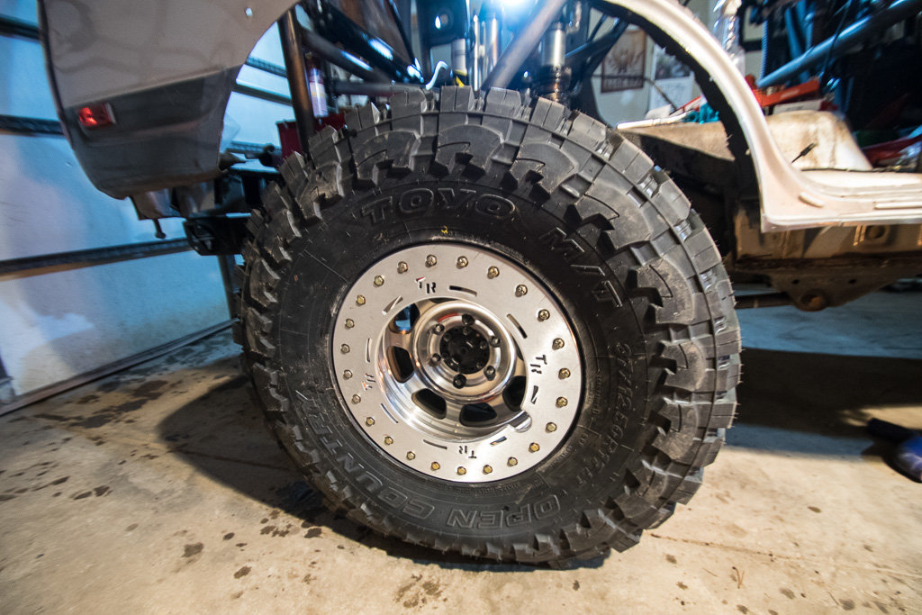

    The rim I just ordered is from Trail Ready. I ordered one for test fitment right now. Chose to NOT have them drilled for beadlock, yet, but they can be converted if I want to later on if I want to commit to that route.
    I did 17" because of the brakes, they're 8.5 wide, and I chose the 3.0 backspacing so I can hopefully eliminate my spacers. At work I get really good deals on Toyos, so I will most likely get some 37" Toyo Mud Terrains to pair with this new setup.
    I nabbed this photo off another forum from someone selling these a while back, but this is essentially what the exact setup would look like for reference.

    I loved my trail ready beadlocks, too bad they were 15s and I had to get rid of them. You wont be dissapointed!

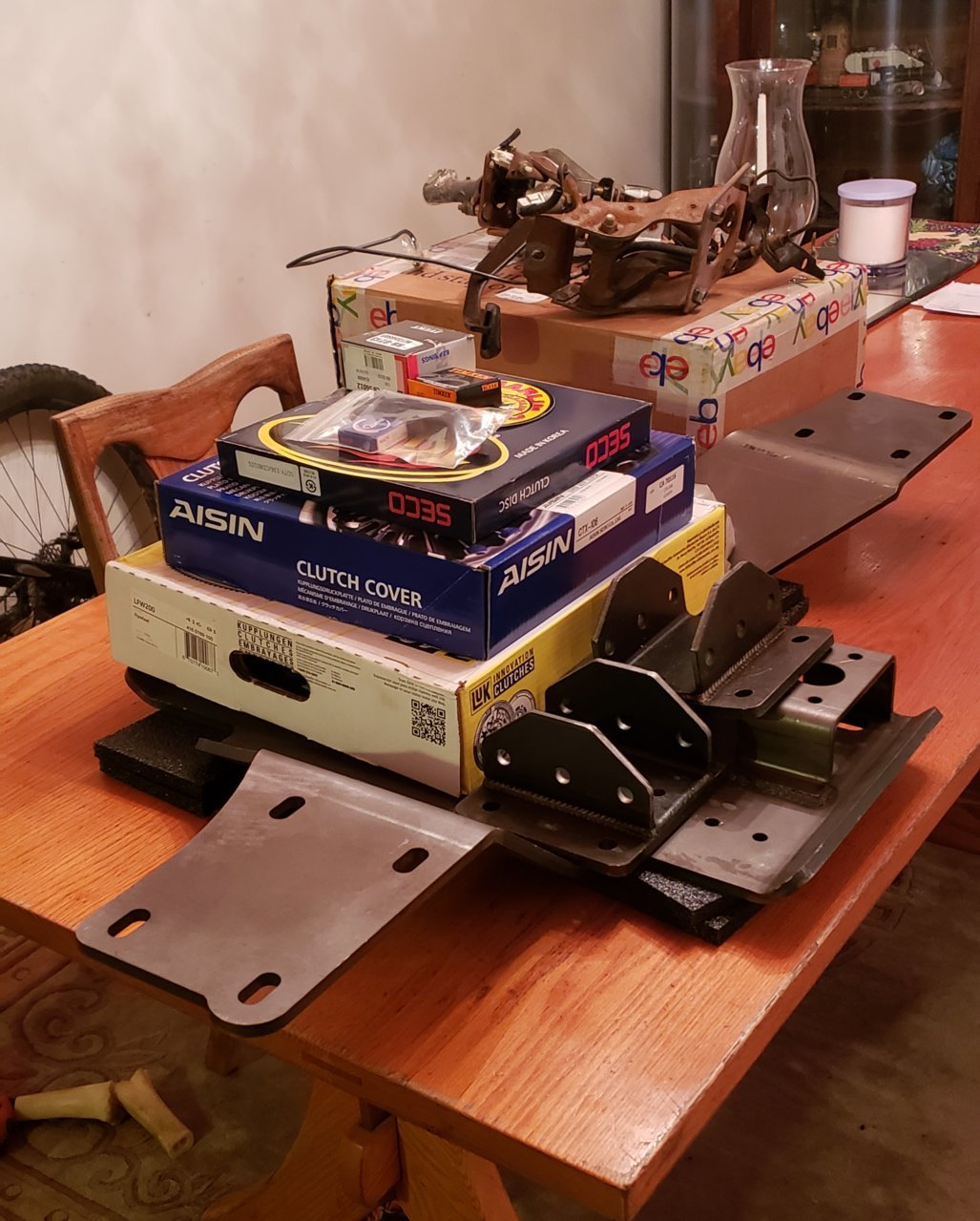

    Guys!! All I can say is holy moly! I was skeptical about the design of the Trail Gear crossmember... But WOW! This thing is MASSIVE! It must weigh nearly as much as me hahahah! Needless to say, I feel much better about it now. That will help a LOT with the install.

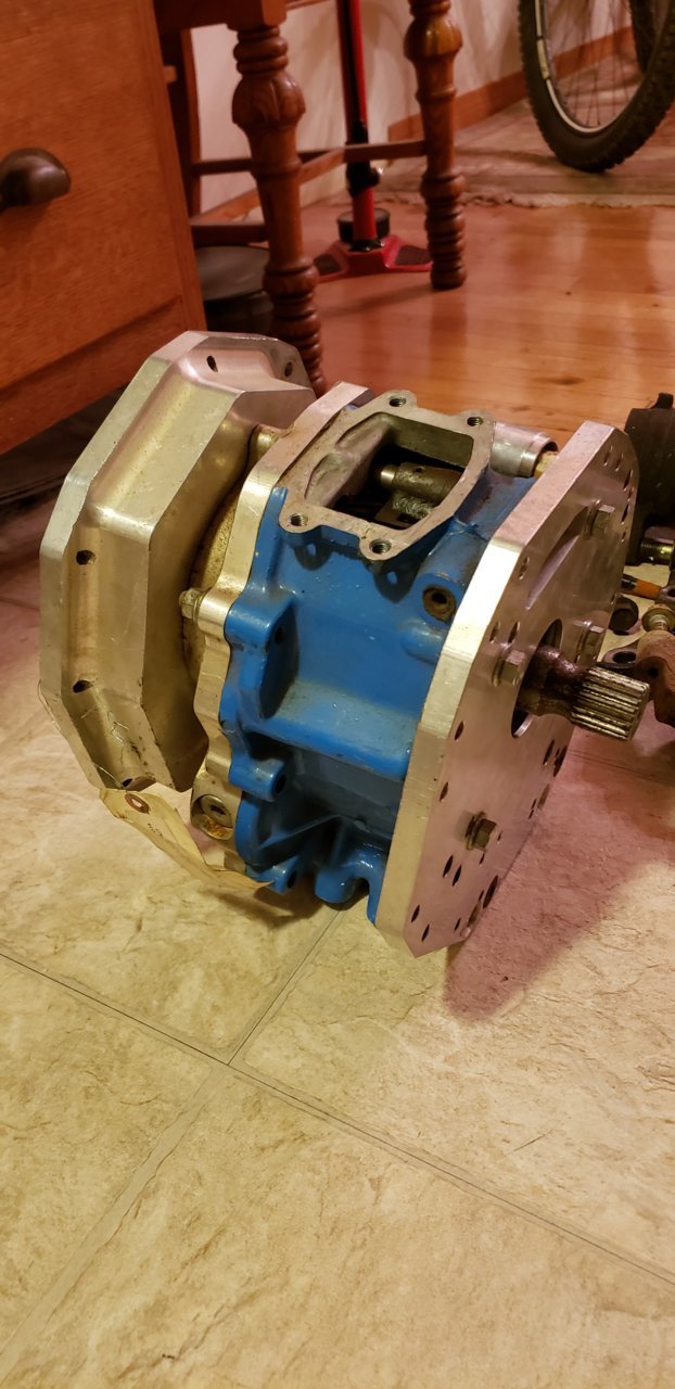

    Thank you Greg! Ironically, the seller included this bearing and mentioned to me about it (I think it handles the load a bit better to on top of the added RPM I believe- I could be wrong here). Just waiting on the last box from him with that and the triple sticks.
    I have not be able to look through the crawlbox thread yet, but it was definitely enlightening seeing the inside of it from the post you linked! Thanks again Greg!
