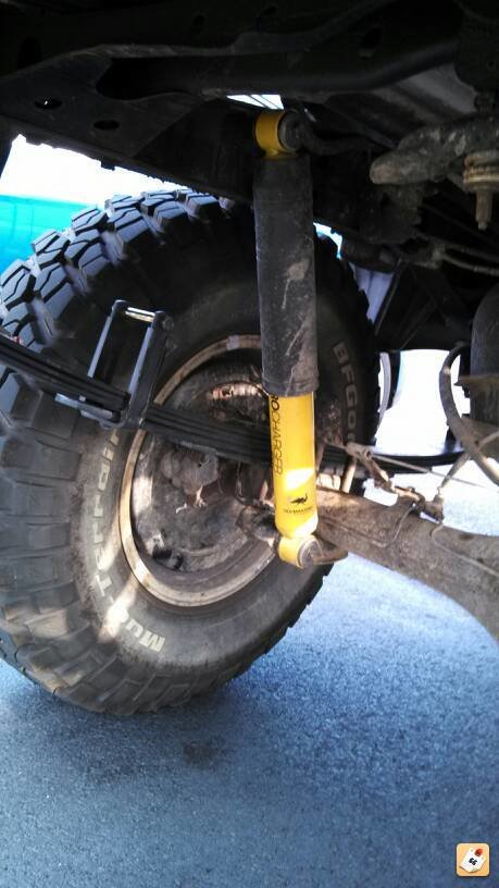

    I installex 10" shocks like this.
  6. Nov 27, 2013 at 10:43 PM

    I have 10'' in stock location so far nothing wrong.

    how do you find the geometry to mount the shocks so they dont bind?

    I just cycled it they are the same as stock laid back but angled in also. No binding at all.

    Its really not that bad. Just gotta think it through for your setup. Park it a full droop and full stuff and measure from the axle to somewhere up top where a new crossmember would be if you're going to relocate. If not measure from the stock mounting locations to get ext collapsed numbers and see how close the shock you want is. I'm running 12" travel 5125's.. and still have some tweaking to do.

    No more roll then when I removed the sway bar. Emailed you the pictures with some measurements. Hope it helps...

    I like how you reused the stock bumps. Is that spacer welded to the All Pro top plate?

    No was enough thread on the spring bolt to just drill a hole in the spacer and use a luck nut to hold it down. I did welded the bump stop to the spacer.
