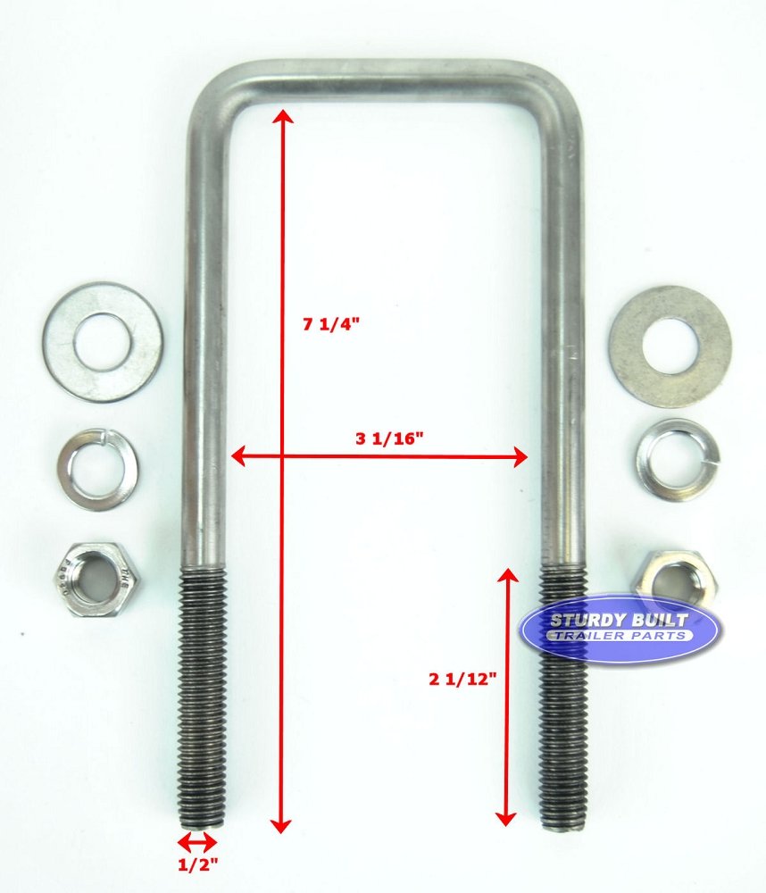

    Just to clarify, U-bolts are universal for the most part right? One of my buddies has a set that’s 10” long.

    They need to fit over 2.5 inch leaf springs but yes universal fit for the most part.

    You buy u-bolts based on the inside width (the 2.5" @rnish mentions for our trucks), the rod diameter (1/2" or 13mm I think is OEM) and the length (the stock 6.5", etc). If you're in doubt buy something longer. It'll maybe stick down more or you can cut them right. But don't go crazy and buy really long ones because you notice they don't thread the whole thing and you can run out of threads before you get the nut tight. The 10" you're looking at pretty much right where you'd want to be if you don't know exactly what you need. It'll probably be 8.5" or 9" give or take, but if you buy 9" Murphy's law is you'll need 9-1/16" long.

    This is the one he says he has for me:
    American Automotive UBLT12-388 Square U Bolts 10" Extra Long Certified Oem Material... https://www.amazon.ca/dp/B017HV2B24/ref=cm_sw_r_sms_c_api_i_V0owBbA8D5A14
