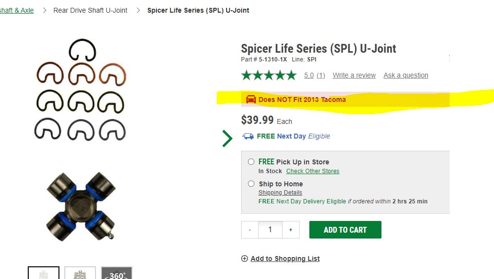

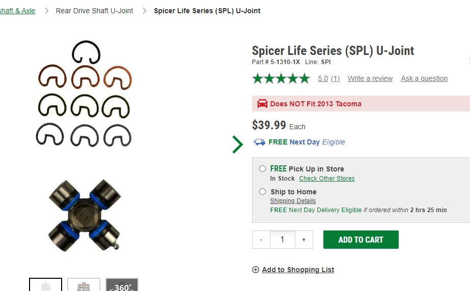

    So I have to ask since you threw out the part numbers. I looked on rockauto and they show a Dana 513301X fitting all 3 joints unless I am reading it wrong. Any insight?
  11. Nov 1, 2022 at 2:18 PM
    BizzyBone
    BizzyBone [OP] Well-Known Member
    Jul 25, 2016
    #192881
    60
    Oh, wow. I didn't know that they use different part numbers u-joints for front and rears. How come O'Reilly only sells non greasable part 51330X and greasable 513301X and don't sell fronts non greasable 51310X or greasable 513101X? Looks like I'll have to give O'Reilly a call.

    If you are talking about the rear driveshaft yes they all use 513301x. The front driveshaft uses 513101x. I'll fix my post to make that clearer.
    In addition I will say that if you do buy them weather you do the install yourself or have someone else do it for you it would be wise to buy extra circlips of thinner sizes. The spicer ujoints come with extra circlips of different thicknesses but when I did my install I found that even using the thinnest ones it was too tight and the clips where bulging out which can cause early failure of the ujoint. I ended up buying some from Amazon which were thinner and helped with the issue.

    Strange. When I look up on toyotapartsdeal it gives me the same part number for the front driveshaft ujoin from a 2007 and a 2013 but can't seem to find anything aftermarket for the 2013.
