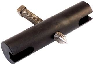

  16. Sep 3, 2016 at 9:34 AM
    #16
    strmtrooper1
    strmtrooper1 Well-Known Member
    May 27, 2016
    #188014
    71
    Jeff
    2015 TRD Sport DCSB
    OME Lift, 33" Goodyear DuraTracs
    ABNFDC[OP], NateMob and DrFunker like this.
  17. Sep 3, 2016 at 10:09 AM
    #17
    ABNFDC
    ABNFDC [OP] Well-Known Member
    Aug 29, 2016
    #195902
    978
    Granite State
    2008 4WD Access Cab TRD OR "Rugged Trail"
    265/75/16 Wildpeaks, Dakar rear, HS 2.5" front coils
    strmtrooper1, Oh those are sweet. I'll grab one for my next life.;)
    Got it all together, torqued twice, blue loctited, and staked. Now to do all three u-joints while I have it apart and add a grease fitting to the slip yoke. The slip yoke annoyed the heck out of me chasing why it felt like I was riding a wagon with square wheels-greased it and it fixed itself.
