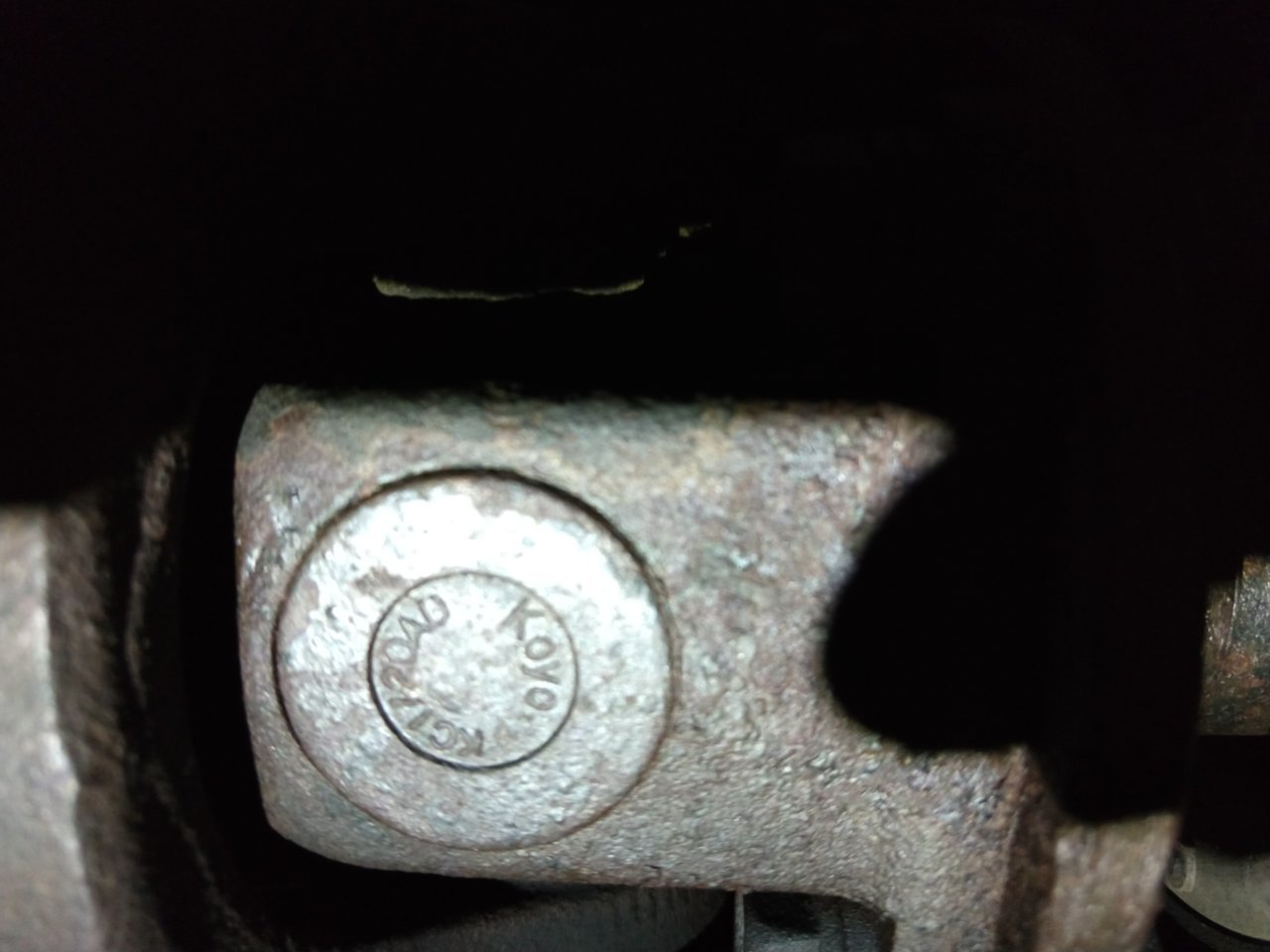

    I need to pull off my drive shaft to replace the center bearing, so I would like to replace my u Joints at the same time. Just the front and rear most... I will leave the double one in the middle alone unless it gives me problems later on . My question is what joints do I buy? I am second owner, and if I had to guess the u Joints on it are original. They don't have the outside clips all the replacement ones like Dana Spicer ones have. So... If I pull out the joints, will there be grooves to accept replacement joint clips? Or does my driveshaft require some special u Joints?
    Picture is what the outside of my joints look like.

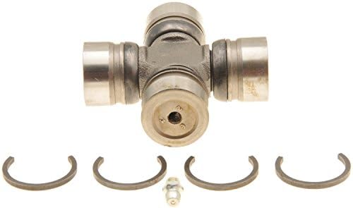

    I've been looking at the same u Joints. Where do the snap rings go? I know they are normally on the outside, but since mine doesn't have them on the outside makes me a little hesitant to order those.

    they go on the inside. Google Timmy the toolman on YouTube. watch his video on 4 runner ujoints. it's the same
