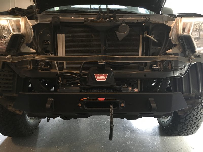

    I'm posting this picture that shows the Warn VR8000s winch in it.
    The center support bracket had to be bent just a little to accommodate the solenoid fixed to the top.
    I'll also mention, I did mount the bumper first and then the winch. Because I was by myself this was easier to an extent. It was NOT that easy to tighten the winch bolts, but I did it.
    Also, the hawse fairlead that comes with this winch had bolts that were too short to mount up. I ended up getting some grade 8 bolts from Lowes to mount it. They ended up being slightly too long. So I cut a half an inch off of those so the mount ended up fitting.
    This bumper is really well made and the combination of the weight isn't too bad. It is heavy though for my little RC. Keep that in mind. I doubt any V6 owners would notice much of a difference in drivability.
