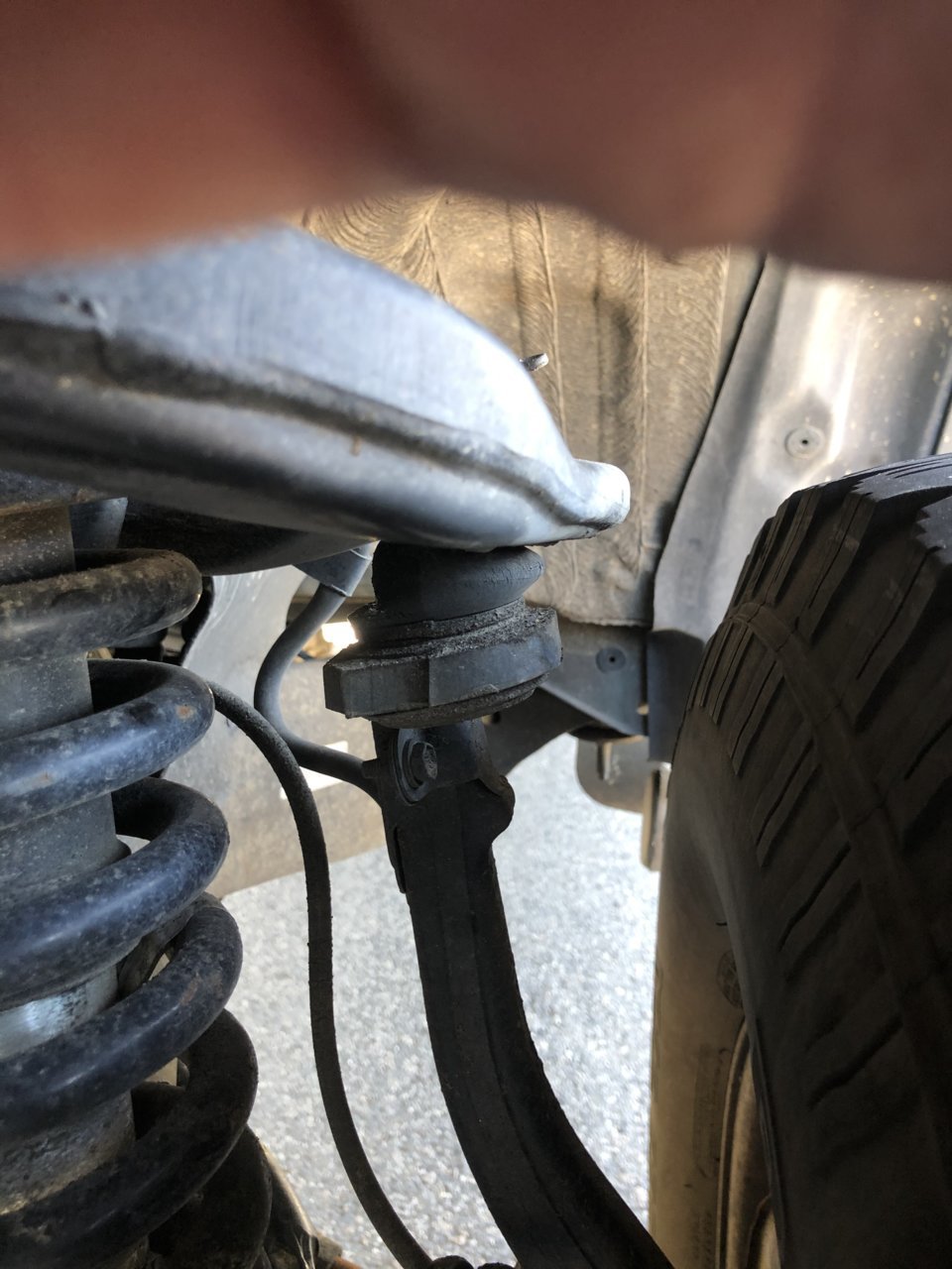

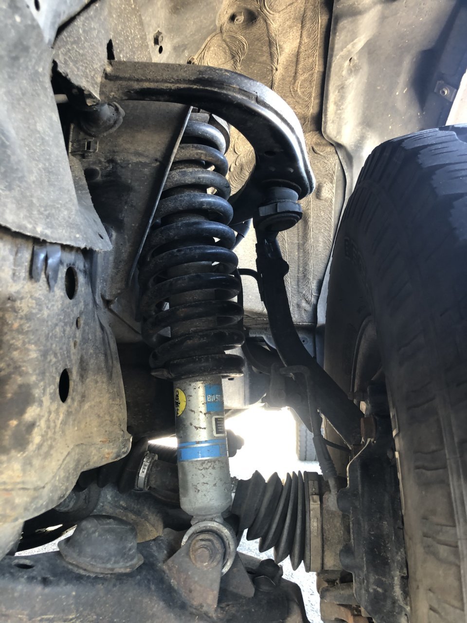

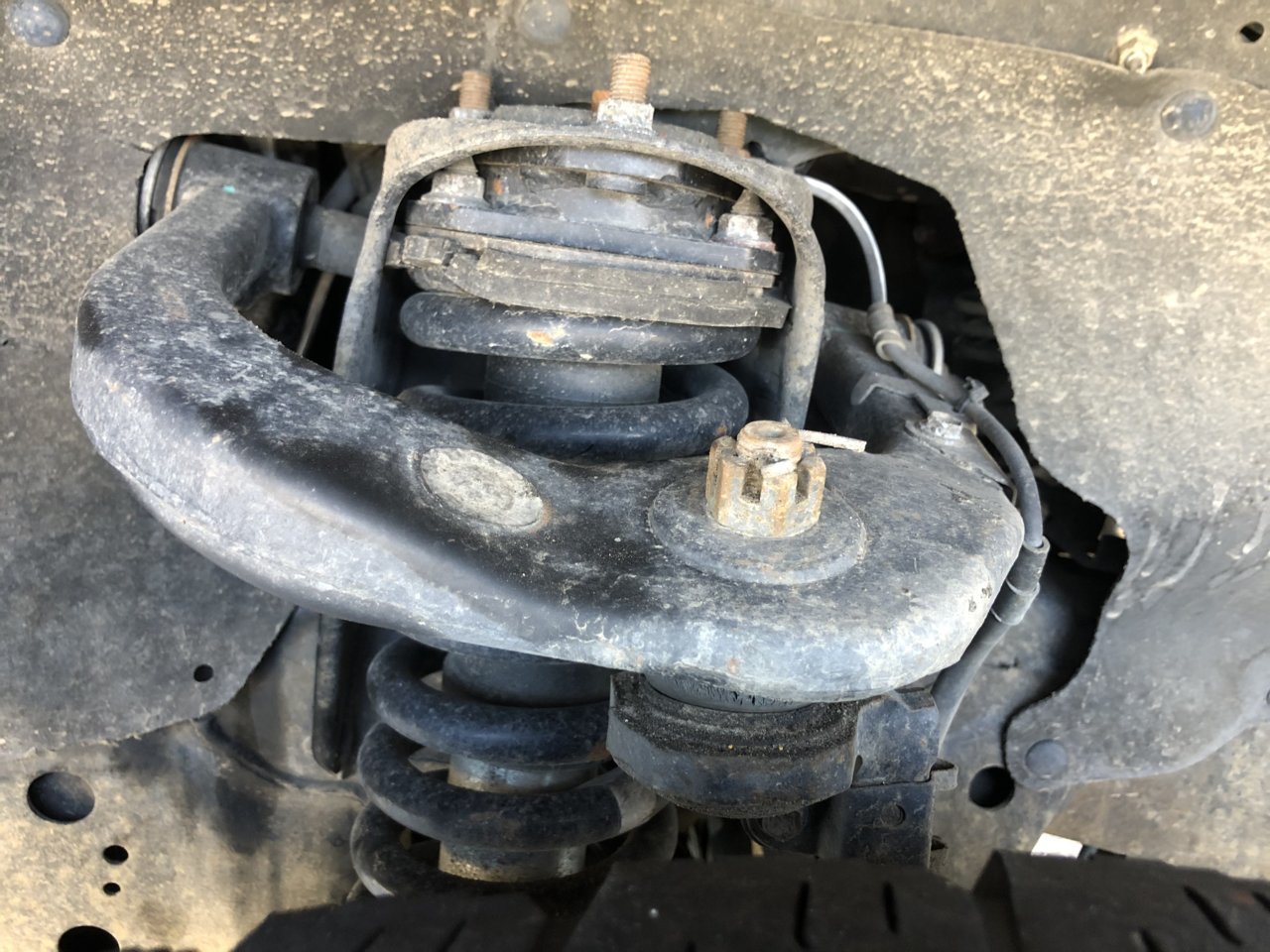

    Uploaded a few images of my suspension at rest with tires on the ground.
    The clear rocking that i felt at lunch is gone. Loaded or unloaded. Tires straight, left or right it is solid. I am still going to take it apart.
    any more info to share about my UBJ at rest and my lift? Am I out of range?

    I mean I’ve definitely seen worse on here. I think 5100s are a longer shock so you’re gonna get 2-3” of lift depending on the setup+ your spacer. Ideally you’d have after market UCAs to fix your caster, but plenty of people with 2-3” lifts don’t have them. Do you have your alignment sheet from the shop that did your alignment? Premature UBJ wear is definitely a weird one...

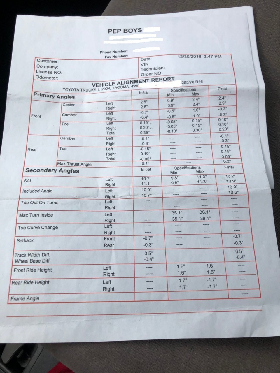

    Time flies and this whole COVID mess does not help so it has been more like 2+ years since i installed the 5100's and 881. The MOOG UBJ would have been within 6 months of that. Last Alignment attached. I should also note that both of my front tires are totally shot on the outside edges and i am feeling high speed shimmies.
    Help me understand. Looking at my UBJ it sure seems canted way over. Like if i was to compress the suspension it would run out of travel and blow out. I have had a knock in the suspension for a little while now that happens when i go up driveways at an angle with more than slow speed. (Quick left or right hand turn into a parking lots for instance.) I swear was coming from the rear but have never found it. Now i wonder...
    Does the UCA lower the attachment point of the UBJ and put it into a more neutral position? Does it pull it in? What is it doing to correct this?

    Your caster is definitely maxed out, but it sounds like your outer tire wear would be a camber issue. Caster may have some affect but I don’t think it would blow out your ball joints and cause that much tire wear. Plenty of people on here run lifts without aftermarket UCAs.
    If anything your ball joint would bottom out on full droop. Your UCA when truck is sitting level should be pretty much level, maybe drooped down a few degrees below level (again though depends on how much lift). Your UCA definitely is drooped down a good bit. Do you have your sway at removed? If so then that’s your problem, your sway bar limits droop so without it either your shock is going to bottom out or some suspension components are gonna make contact in this case it would the the UCA contacting the spindle and putting undue stress in the UBJ.
